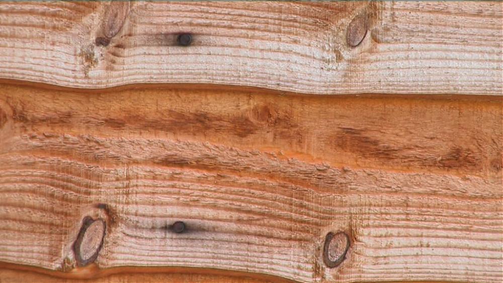

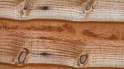

To begin with I have been shooting hd and using in camera down conversion for the time being until I uprate my computer to handle ample hd footage.
I have just shot some comparision footage of a Close up of a fence because it is an area of high detail. The reason being is to compare the down-converted clip to the standard sd clip and what I discovered is very dis-pleasing. (see attached stills, the first is the down-converted)
It would seem there is much detail loss in the down-converted clip and an overall loss in sharpness.
So now I am worried as to whether a down-coversion in final cut will be far superior to the nasty in camera downconverter.
You thoughts please.

Thankyou for the info Maksim. My system is infact far capable of capturing and storing plenty of sd footage, I have hundreds of clips stored already.
My main worry is this-
My project when finished is going to be in sd, however I have chosen to to shoot in hd and down-convert in post after reading that down converted material is of the same or superior quality to sd (with the added bonus of using the hd at a later time).
Now after comparing the sd to down-converted hd from the camera I am worried as to whether this is the best choice considering the clearly apparent lesser quality of the down-converted material, as can be seen in the stills above. So my main concern is whether this clearly poorer quality of the down-converted material is just the result of a poor down-conversion in camera rather than a better result from converting in final cut pro or similar.
Finally, are my finding's justified as to the apparent lesser quality of the in camera down-converted material? What are other peoples finding's on this matter? and is there an explanation for these finding's or maybe my camera is faulty.
To top this all off, I also have the nasty black line at the top of the screen with my in camera down-converted material which it would seem is becoming an unresolved universal matter for all A1 owner's.

Hi Tom,
If you are working on an older Mac, Capture the footage within FCP as HDV. Reveal captured file in the Finder and drop into Compressor, Down convert your footage to DV here adding in the filters tab about 10-15 in 'Sharpen Edge'.
The resulting file can be then edited within your normal DV timeline. Make sure the to constrain aspect to 16:9, frame size will be the 720 x 405.
This yields much better results than in camera conversion. When you upgrade your Mac later there will less to worry about as you can use FCP 6.
I should add this works best with the 25p setting.

I do apply a little sharpening on any down-conversion, just like if you resize a 40mb photoshop image down to web size, it will need sharpening to bring back the detail.
I suppose it's down to personal preference.
