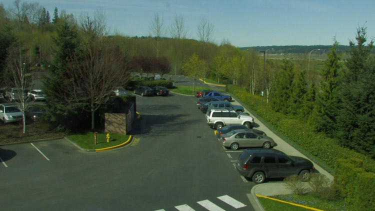

Can someone please test this preset in a variety of situations? I've been trying to develop a preset that gives vibrant colors but without a color cast. There have been reports of magenta hues from other stuff I've created.
Gamma: Cine2
Color Matrix: Cine2
Color Gain: -15
Color Phase: 0
Knee: Low
Black: Middle
Master Ped: -7
Setup Level: 0
Horizontal Detail Frequency: Middle
H/V Detail balance: 0
Sharpness: 0
NR1: Off
NR2: Off
Coring: 0
Red Gain: 10
Green Gain: 15
Blue Gain: 15
RG Matrix: 10
RB Matrix: 10
GR Matrix: 10
GB Matrix: 15
BR Matrix: 25
BG Matrix: 25
Below is a still using this preset...

Hey Steven, I haven't tested this, but judging from the still, at least on this monitor, it looks as if it has a green cast.

I had the same feeling before I scrolled down and saw Bill's post. To me even seemed to show up in the tracks in the parking lot and in the black top...

Yeah, I was looking at it on an uncalibrated monitor in work and now that I see it on my own monitor, it does have a greenish cast. Back to the drawing board. :)
EDIT: Actually, if anyone wants to take a stab at maintaining the vividness of the preset and losing the green cast without getting a magenta hue, I'd welcome it.

i can't post an attachment, but using color correcton i got it quite nice in vegas.
just boost the red midtones and a hint of saturation in the preset and you should have it.
here's an upload http://www.photoposting.net/fullsize.aspx/IDp~5920
