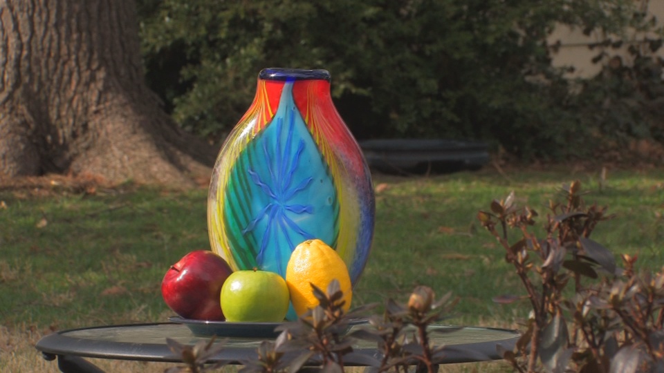

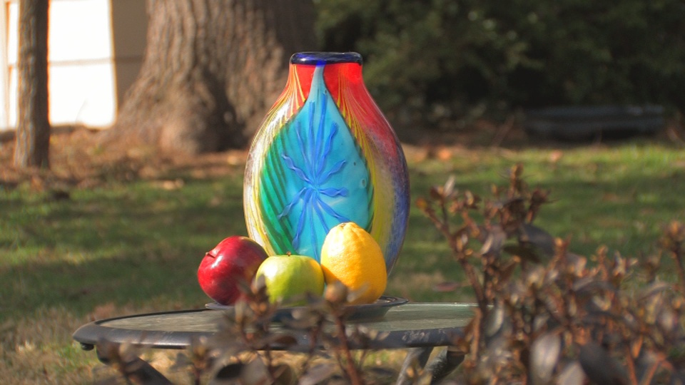

Hey Steven –
Check these out.
1. Steven vivid-wht bal.jpg: I white balanced to the available light.
2. Steven vivid-wht bal-less sun.jpg: Same white balance setting, less sunlight (sun went partially behind the clouds)
3. Steven vivid 5500k.jpg: White balance set to 5500K – and – ND 1/32, App – F2.8
I wanted to turn the preset off to the factory settings and shoot the same thing (and post a .jepg of it), but the sun disappeared for the rest of the afternoon – just as I was getting ready to do so.
I’d still like to do this – and think it would be valuable to do so in order to have some sort of visual baseline.
The preset is definitely vivid – and seems to work well with still life, nature, plants -- but I’d still like to see what it looks like on people/skin tones and other ‘real life’ scenarios where our brain tells us what looks right and what doesn’t.
Nice work – thanks…
Note -- the highlights are blown out a bit...sorry

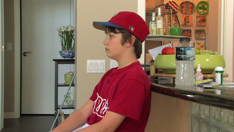

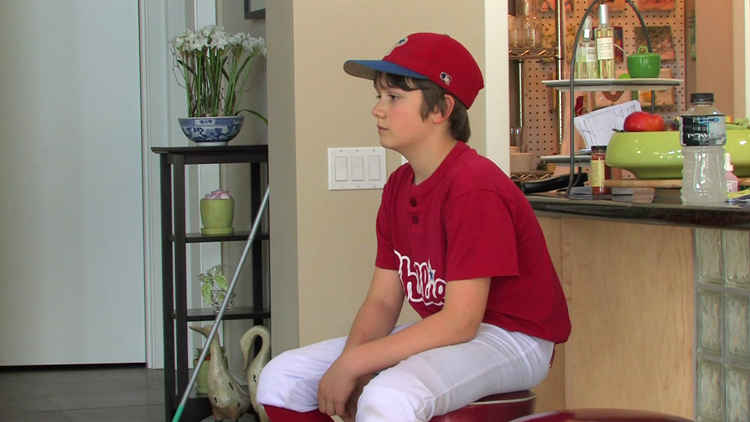

James, looking good. Thanks for your test.
A caveat for this setting: stay away from fire engine reds and neon orange colors like those found on some street signs. You will definitely experience a pulsing from them. But if you can control your environment to exclude these extremes, I think it is quite nice.
Okay, here are some tests I just did with the latest preset settings - post #77 (I can't tell if there is magenta in these because my eye sees magenta now whether it's there or not. This preset has damaged me psychologically):

I like those!

Those look like wonderfully natural colors to me. I don't see a magenta cast at all.

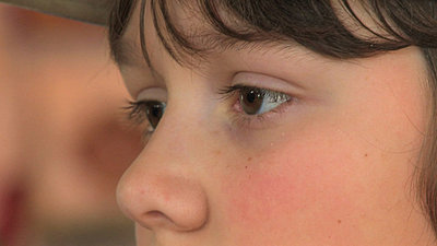

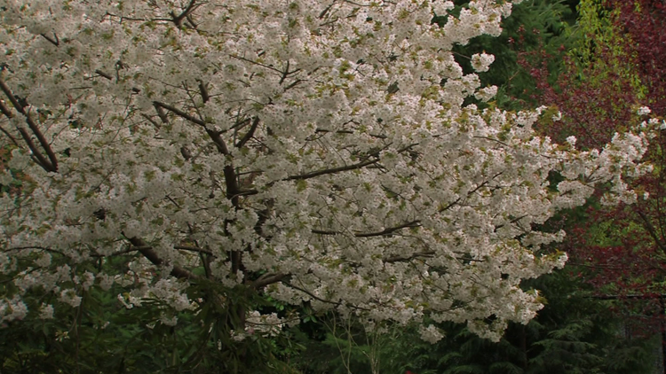

More tests
I reduced the color level to 25 as Tom suggested and he is right, there is no discernible difference in the vibrancy but the noise level is reduced.
I wanted to test the preset's response to red so here are some more tests including another skin tone test with color gain at 25. While this is an intense red and it did fairly well, there are all kinds of reds that may look better or worse:
