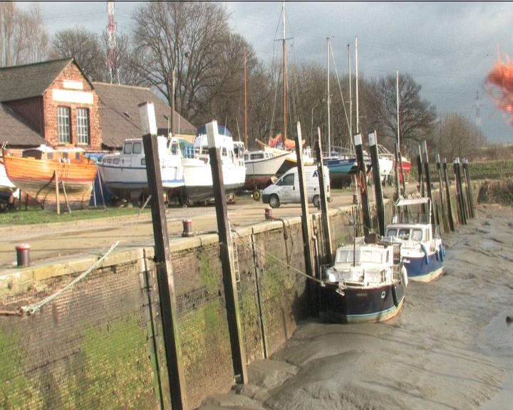

I would like to have some more feedback regarding a problem with the 'HD DOWN-CONV' (HDV to DV downconvert) option, available the XH A1's VCR mode.
In both HDV mode as DV mode our XH A1 delivers perfect footage. No issues. This is a magnificent camera, delivering high end video output, no discussion.

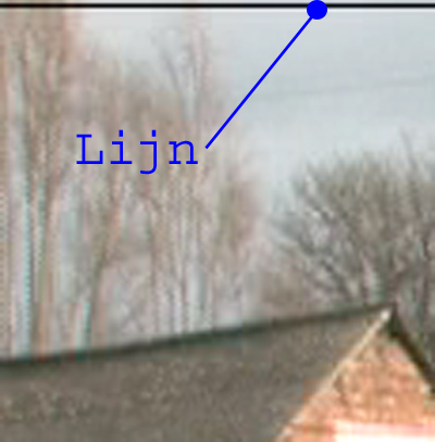

However, in the downconvert option - on top of the frames - there's a flickering black line. It's not really against the frame border, but a few lines lower.
Probably only one interlacing field is affected by this phenomenon, the second isn't (...not easy to find out, but it looks like that). With some effort this also viewable on the camera displays, but surely during the capturing process seen on the computer and, and evidently stored in the captured files.
We did try several NLE's and capture software, (very different) computers, firewire cables: this is not a 'computer issue', but the camera generating something funny, however, the phenomenon only appears when the firewire cable is plugged in
First I thought this camera was defectuous or more likely, there was some kind of software/calibration issue.
After an extremely tedious helpdesk discussion process with Canon support, and after involving a third party company executing the repairs for them, the decision was taken to exchange this camera with a new one. Out of 'commercial reasons', because according to them the original camera was entirely within spec (so in fact, telling me that I've got bad eyes).
Guess what... this XH A1 is showing the same problem, in a completely identical way. So this seems to be a more generic isse.
Are there other people out experiencing the same?
Note: this is a PAL version of the XH A1.

I have exactly the same problem with my A1. You don't see it on a monitor, since it's in the overscan area, but when looking at footage in the Premiere Pro capture window or in Windows Media Player or other viewers, it is very apparent. It only happens with HDV to SD in-camera downconverts. There is no difference with 25F or 50i.
