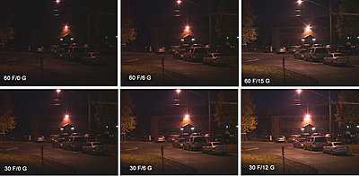

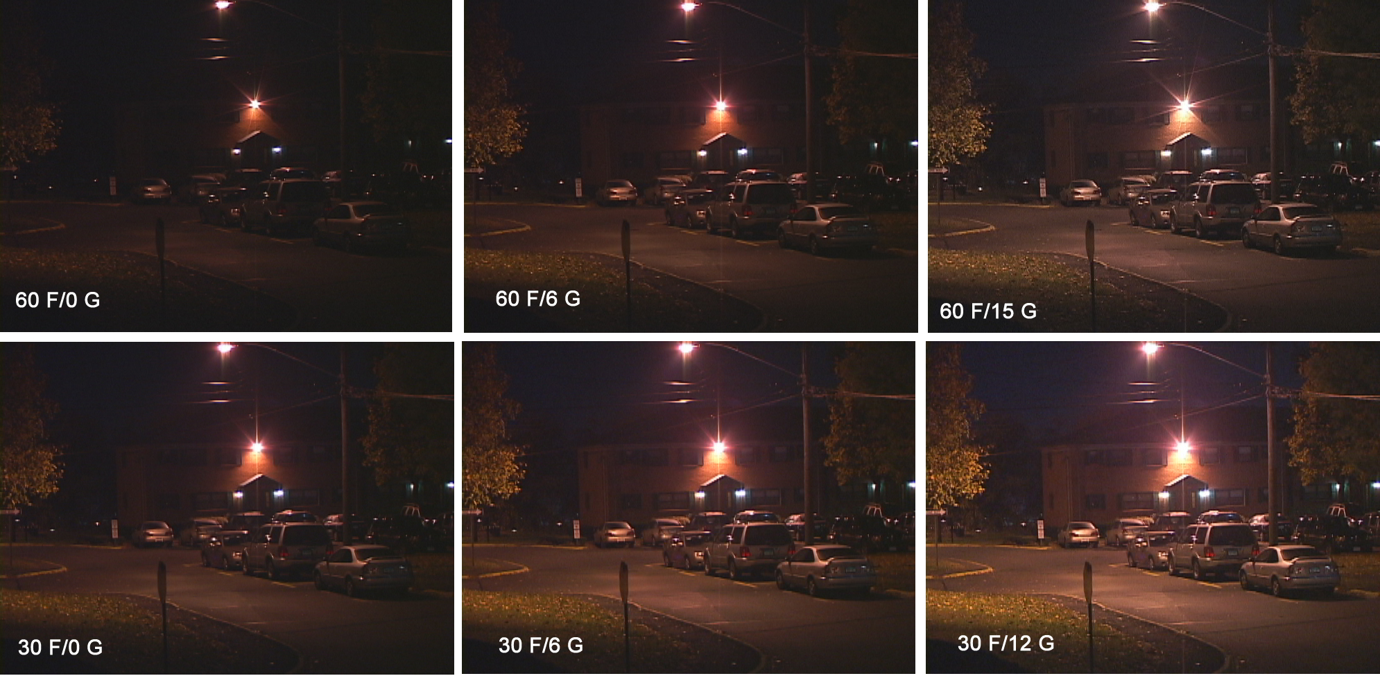

This is a pic of a SD Sony PD170 at night with various settings.

No offence but the PD170 looks horrendous, especially the way its dealing with the actual lights.

With respect, shooting at a very slow 1/3rd sec which is what i believe you used for the cars-from-bridge shot means you're not going to have to use much (any?) gain!! So really in my book the comparison to another cam when one is shooting at 1/30th & 1/60th and the other is shooting at 1/3rd sec is completely invalid.
The PD170 shots were shot at either 1/30th or 1/60th. Would be good to see a cars-from-bridge screenshot shooting at 1/30th or 1/60th.
