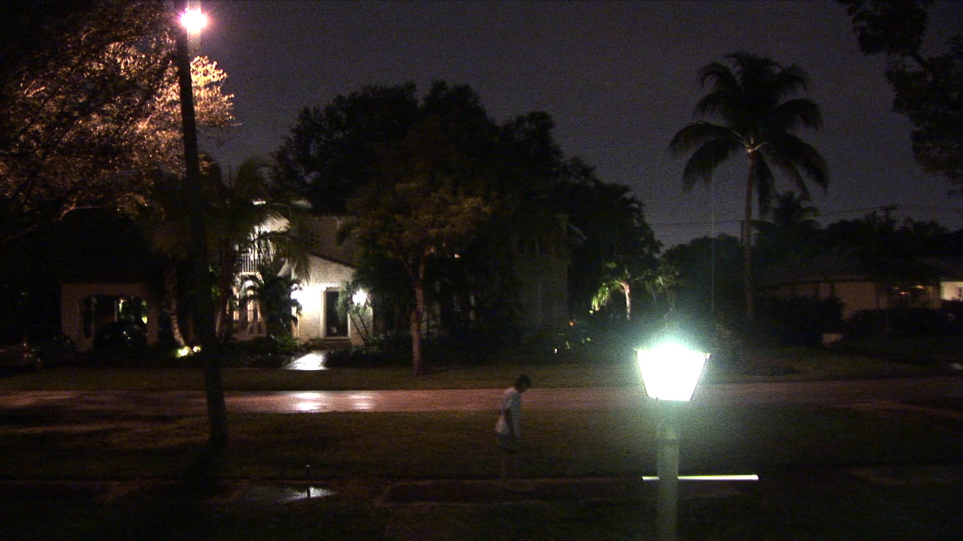

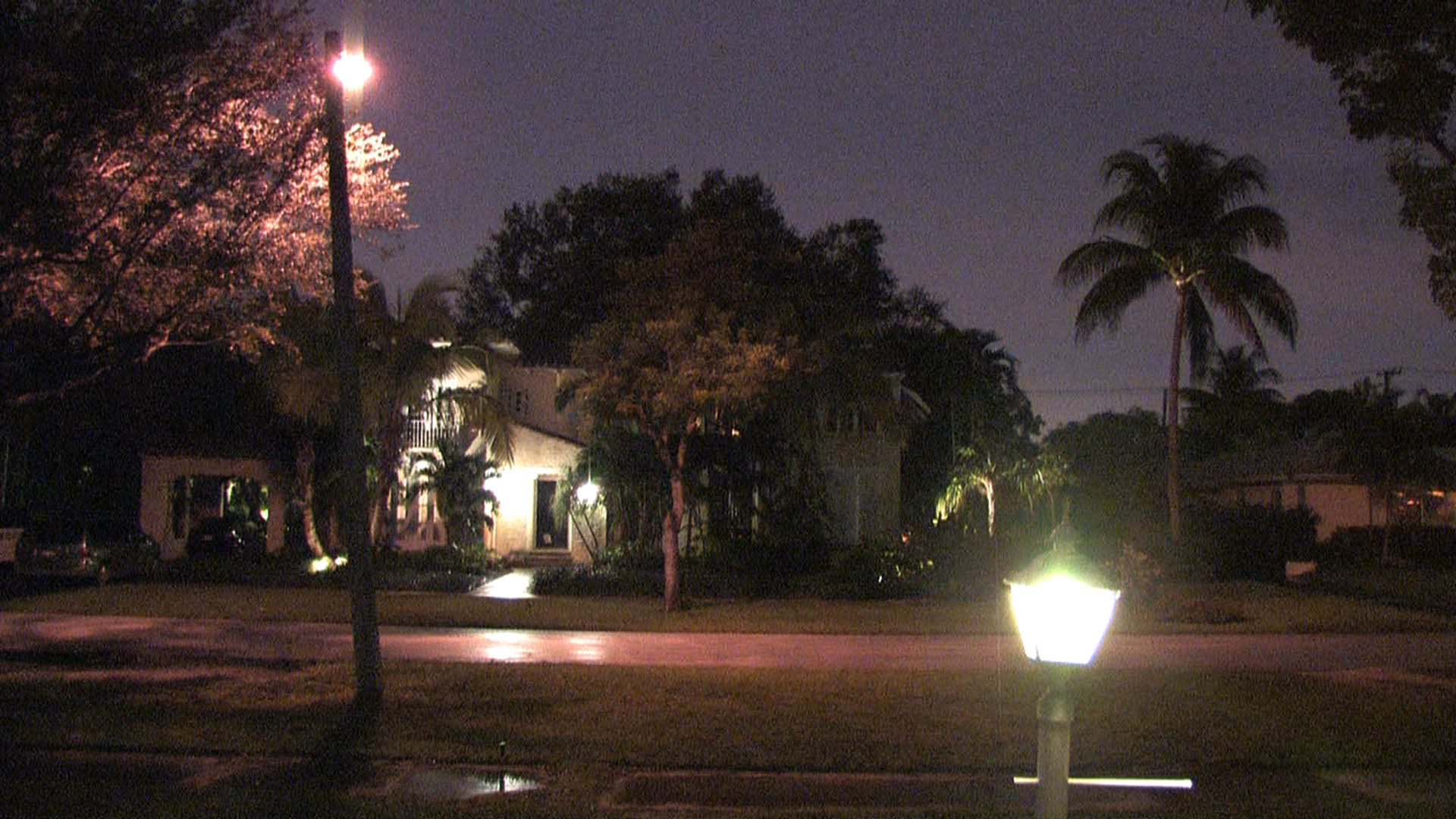

HERE'S NOISE WITH GAIN FULL UP
Here's a framegrab from a Canon XHA1 with AGC on, wide open at 1/15th sec on a dark street. I don't know what db level that gain is. If you turn agc off and put it on H gain, it's 12db and looks the same -- which is brighter than the Sony at 18db gain. I also have a frame grab of a Sony Z1U at 18db gain, 1/15th second wide open. The Canon is brighter but they're both noisy.
These are still frames out of fcp, de-interlaced and resized to the correct aspect in photoshop, and uploaded as "7" quality jpegs.

Thanks for the pics.
Still grainy, but the light is very low. It looks to be brighter grainier, but with more color than the Sony. All in all I am impressed. The Sony does very well for cramming that many pixels into a 1/3 ccd, and from the looks of it the Canon is right on it's heels.
I am interested in what DB the Canon was at. I know it was on AGC, but typically don't Canon's stop the Auto gain at 12db or 15db and only 18db with user input? I could be wrong but that is what I remember with my Gl2 years ago.

The Kaku clips of nighttime streets didnt have anywhere near this much noise. Whats up? It really looks like gain has to up somewhere.

The picture on the left looks overexposed for the conditions; the one on the right is closer, probably. But from the lights it should be pretty dark. It looks to me as if you're trying to bring the darkness up too high with both cameras.

Maybe people are forgetting to turn off the AGC switch? According to page 60 and 61 of the manual, when in Auto (A) mode, you can control the gain with the H-M-L gain switch but the AGC switch must be off.
I remember a similar uproar when Mikko posted noisy footage from IBC on another site but admittedly he was not familiar with the camera. Kaku's taxi footage definitely does not exhibit this kind of noise. It's pretty clear the camera is not at zero dB in Daniel's footage, in my opinion. Perhaps this is another case of operator unfamiliarity. The discrepancy between Daniel's footage and Kaku's footage is enough to be cautious about making any conclusions about the footage until we get more information.

..however, this 'comparison' proves nothing about picture quality. all it tells us is that the canon will boost its gain more in auto mode. if you kept the settings the same as they are in these clips but lowered the gain down on the canon, you'd have a picture that more closely matched the sony (perhaps more grain or less, perhaps better, perhaps worse.. dunno, can't tell from the video.).

Thanks for posting this Chuck ... did you try the "black stretch" on the Z1? I have heard that this improves the lowlight performance.
