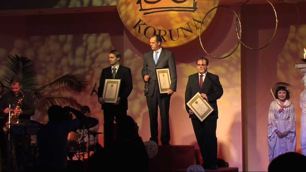

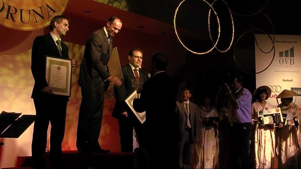

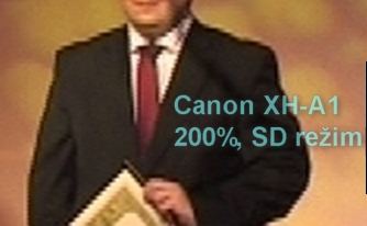

you can see pictures from JVC GY-200 (SD 16:9) and XH-A1 (SD 16:9), resize to 200pct, side by side.
Replacing XL1s with A1-gy-200_crop_and_resize200pct.jpg   Replacing XL1s with A1-xh-a1-orig.jpg

Thats quite a difference Paul. Fortunately there is over a 2K price difference between the 2 cams and the JVC is way out of my price range, otherwise I would be bummed.

You are wrong. JVC is there only becouse I use this two camcorders.
This mistake has only Canon Xh-A1, all other camcorders are ok.
