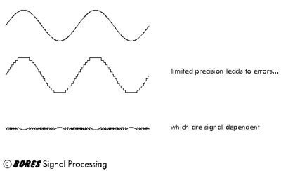

The ground idea is always to record as loud as possible. -6dB uses only a half of the possible dynamic range (this is logarithmic scale) and resolution of 16 bit. -12db only a quarter of them.
There ist always a quantisation noise and noise from mic preamp etc. It is important to record with highest amplitude to have a greater difference to noise amplitudes.
So if you record voice to 0dB - ist qauntizated always to one of the 65535 levels of 16bit resolution.
If you record the some voice to -12dB - you use only a quarter of the amplitude an you have only 16383 levels of quantisation.
Due to this uses recordings studios 24bit resolution. To have enough resolution with lower audio levels and bigger precision with postproduction.

Thanks Ivan. You've explained that very well. I had no idea you lost audio resolution at lower volumes. So basically you need a high signal to noise ratio. Will try to record as loud as I can without hitting the dreaded red -0 dB!

With 24 bit recording you have a lot of reserve of dynamic range - compare to 65536 levels of 16bit - there is over 16,7 millions of quantisation levels by 24 bit. You don`t really need a limiter for recording. Recording "safely" to -12dB in 24bit makes still better quality as 16bit at maximum level.
