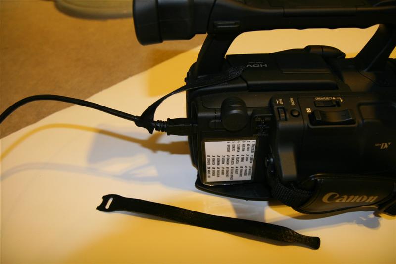

I am finding the combination of the A1 and the FS-C hard drive recorder is quite good. However, last night while shooting with the FS-C hanging off my belt and the firewire cable plugged into the A1, the firewire fell off the A1. For a few moments I didn't notice it. Fortunately the footage was not important but it did get me thinking...what if? What if the cable popped out during a shoot?
The problem is the little 4 pin connector that plugs into the camera is not secure! I am sure others have discovered this and I was wondering if anyone has come up with a fix. Hopefully the fix doesn't interfer with being able to disconnect the cable quickly and easily.

Possible solution
This is my fix.... I hope. I haven't field tested it yet but I know it will be a massive improvement. It is probably kind of hard to see in the picture but this is what I did. I used a velcro strap...the kind you buy for using to tie up wires. You can see the type of strap just below the A1. The strap wraps around the firewire... as you can see one installed on the firewire. I cut up a small self adhesive velcro receiver pad and stuck it just under the A1's handle (it's really hard to see that in the picture). Now the strap holds the firewire more securely to the camera yet it is easy to pull it off when you want to disconnect the firewire from the camera.
