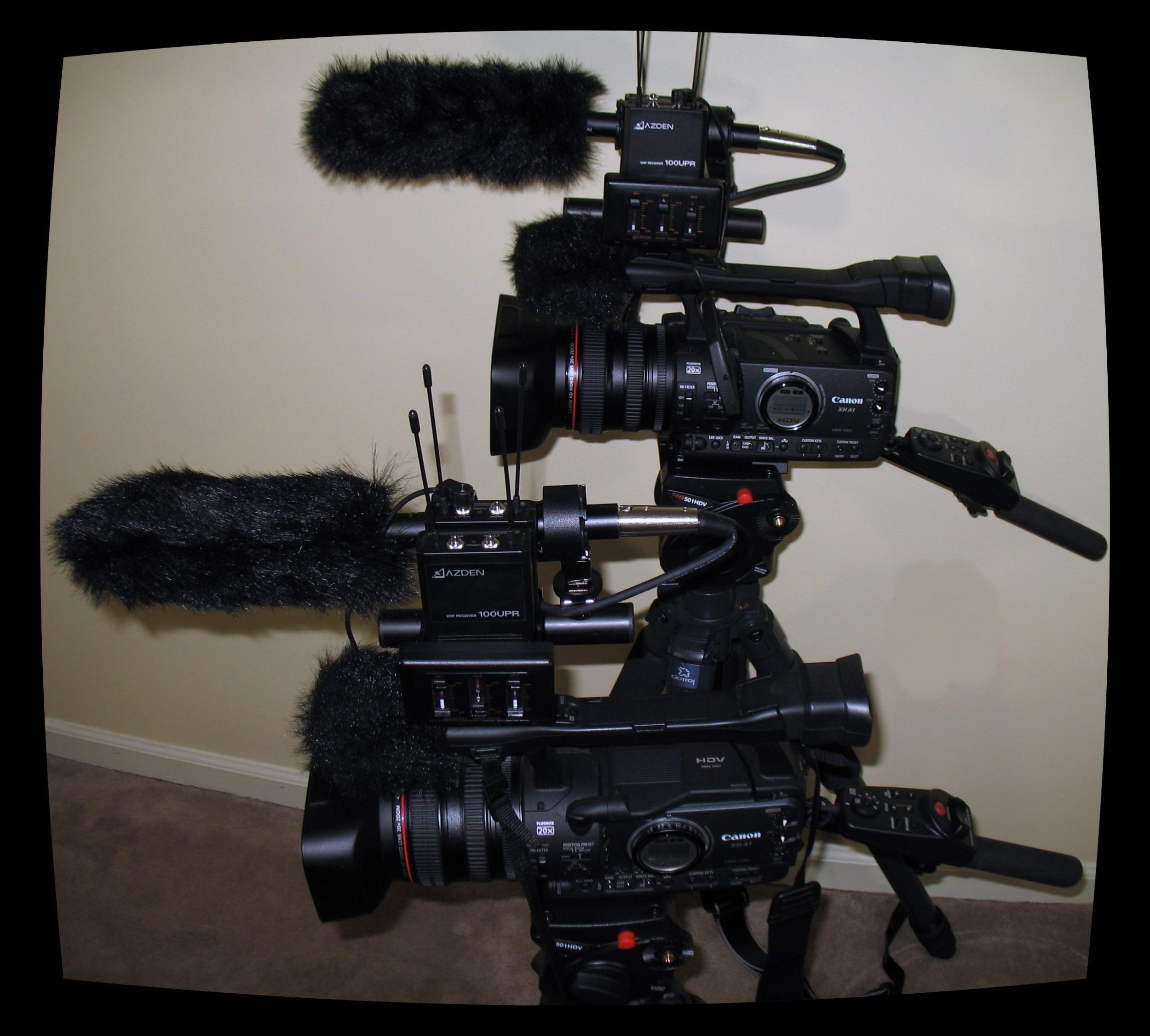

Yes you can...
Here are a couple of my cameras using 2 azden wireless mics, and the shotgun mic.
[A1] How to capture two wireless devices + Capture ambient & XLR input?-img_1364-new.jpg
