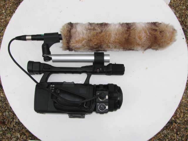

If you try to use mics as long as the ME66 in the holder of the A1, you risk seeing them in the frame. For this kind of use a J-rod (http://www.thej-rod.com/) is a good idea.
(I made one myself, BTW. It is pretty easy, look at the attached pictures.)

Originally Posted by Jeff Rhode View Post
Nice Jerome !
I guess imitation is the best form of flattery.
(blush)
My only excuse is that I live in Germany and that the J-Rod was not easily available where I live (to my knowledge at the time). But I have to admit that your idea is pretty good!
