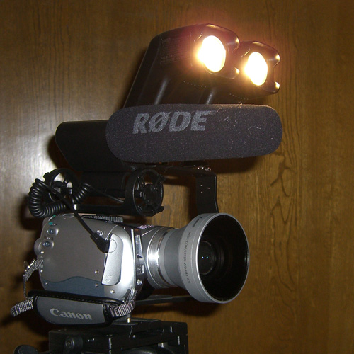

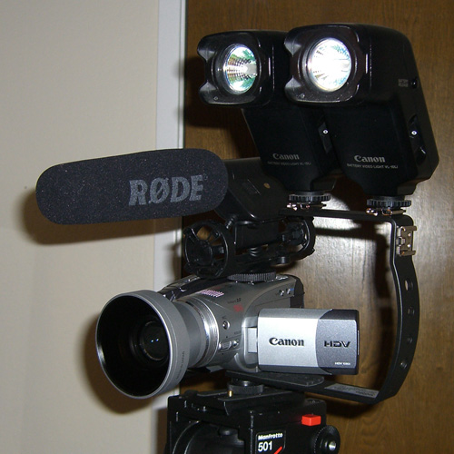

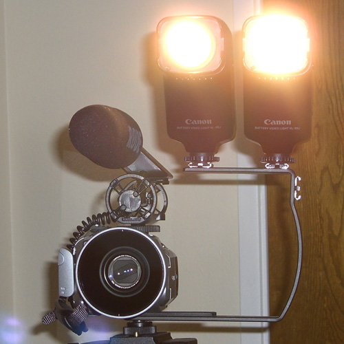

check out my twin lights setup using 2 Vl10s

Thanks Taky -- I have never seen anybody use twin VL-10i's like this before -- it's like headlights!

it looks like a robot from a distance. :)
