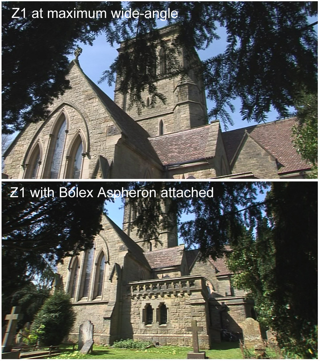

Paul - LED lights that are any good are pretty expensive, simply because of the colour balance issue. The last one I bought (at the Video Forum this year) I sent back for a refund, smartish. The Sony 20-DW2 is a goodie for those with Sony batteries (me) and is easily diffused with a Lumiquest Mini Softbox.
The wideangle I use is made by Bolex in Switzerland and I've fashioned a bayonet mount so that it attaches quickly to the Z1. It's a powerful 0.52x and gives zero barrel distortion. Here's a timeline shot taken just on Saturday at a wedding. I couldn't step further back, so the Aspheron saved the day.
tom.
