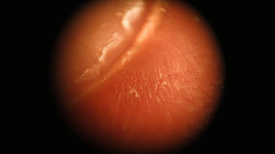

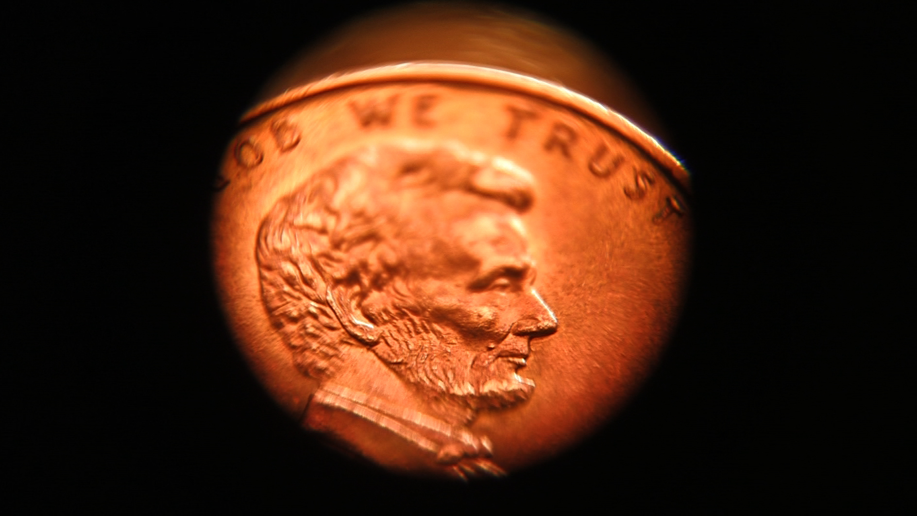

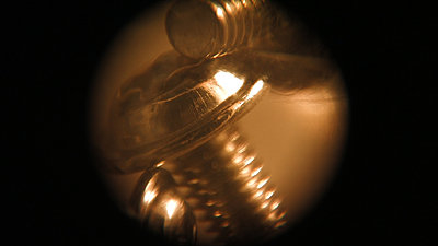

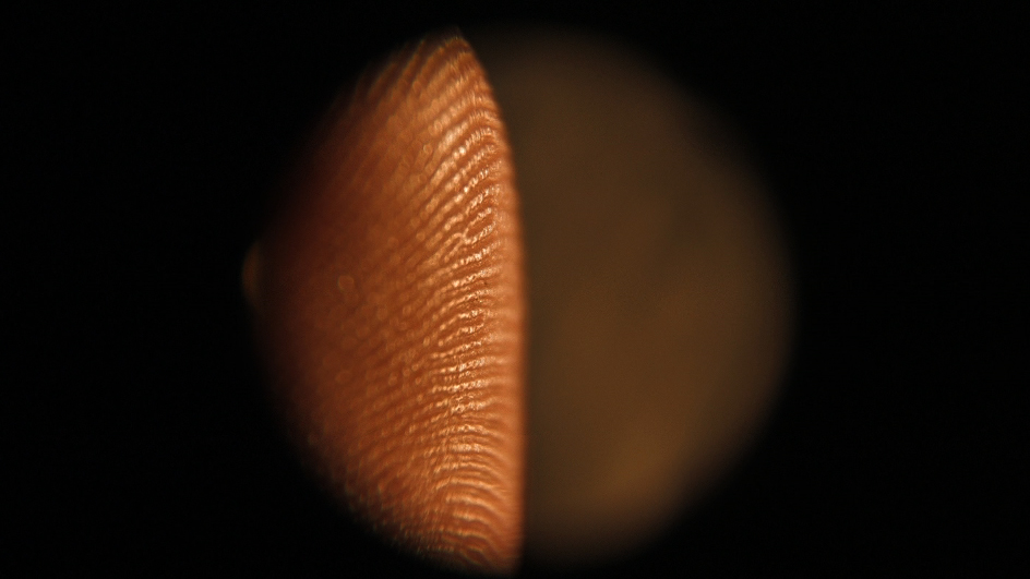

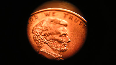

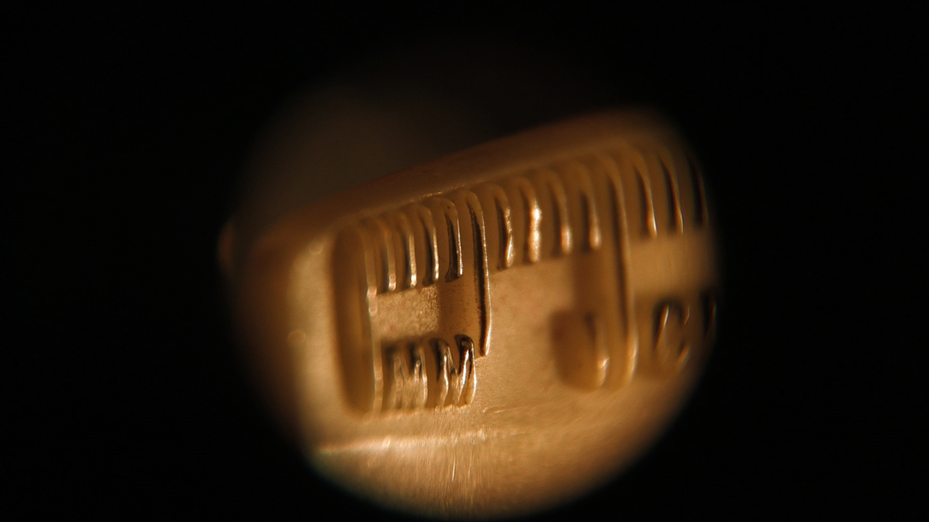

Full rez Images
Ok here are some full resolution images pulled from the source.
I'm currently on a Mac, so I exported them from the source Quicktime clips created in FCP (AppleHDV 1080i60 Big Integer) using Quicktime Pro.
I believe this was all shot using the PanaLook preset, as well.
Now I will describe what each images is (some are self-explanatory, but I'll label them anyway)
1. My fingertip 2. Metric Ruler 3.Tip of my Blowerbrush 4. Small computer screws 5. My thumb cuticle 6. Penny - Year 7. Penny DOF bottom 8. Penny DOF top 9. Dime 10. Spiral Bound Notebook paper (Blank) 11. Spiral Bound Notebook with LoftonFilms written in ink.
Well, what do you guys think? Not bad for a cheap effect, eh?
I'm going to try cropping a clip to DV NTSC resolution to eliminate the barrel distortion and see how it looks...
