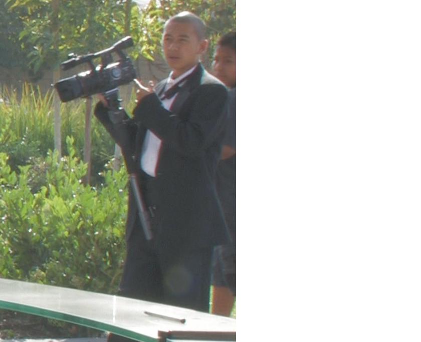

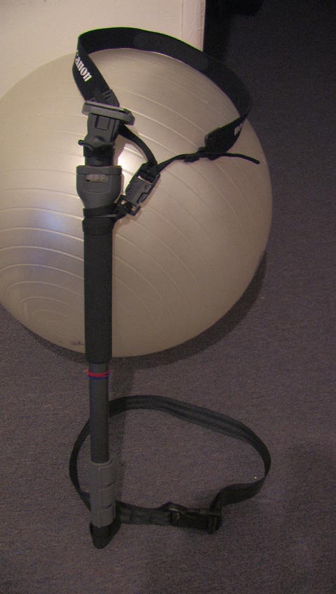

Uh,
using a monopod with swivel head, a belt, some belt buckles, and canon org shoulder strap, one can make body mount for A1.
Need fluid head?, unless your lumbar is out of fluid, lol, (limited panning thus)
hahahaha, point is well taken, Jerome, lol.
The A1 is rests on the pod, stabilized by the shoulder strap and gravity. one doesn't have to "hold" the camera. lifting is easy by releasing the quick release buckle at the neck of the pod; also, pod rests on the belt by a loop,=>taking the system off the body is in split second.
Anyway, it wouldn't look as "pro" as brand name systems, lol.

Doesn't that pole hurt?
Ha ha! Bet it attracts a few predictable comments from bystanders (no pun intended).
I've been using cheap tripods with (their) legs unextended as a brace when needed. The trick is to catch two of the legs in your belt as a sort of bipod.
OK, it doesn't look too sophisticated as the redundant third leg tends to stick out at the front and look a bit rude, but it's more comfortable and stable than a monopod. Also it can be lifted off in mid shot if necessary for instant emergency high angle shots when you notice some clot is about to walk between you and the subject. (Ever tried filming a Disney parade - as soon as it starts people swarm in front of your lens).
