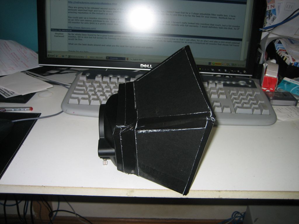

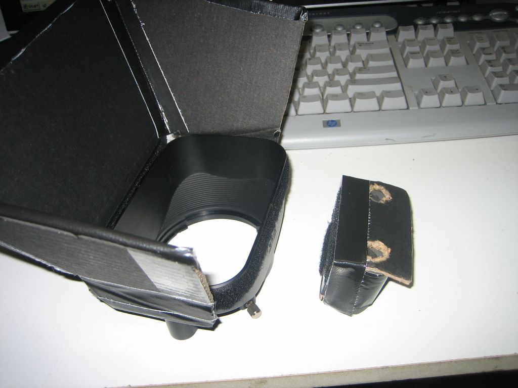

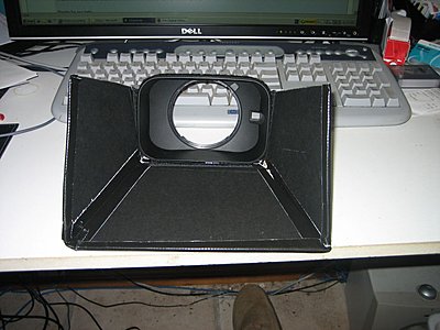

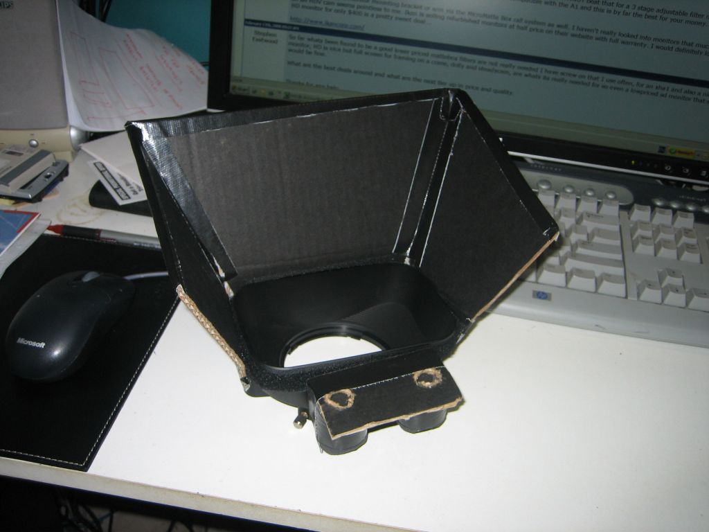

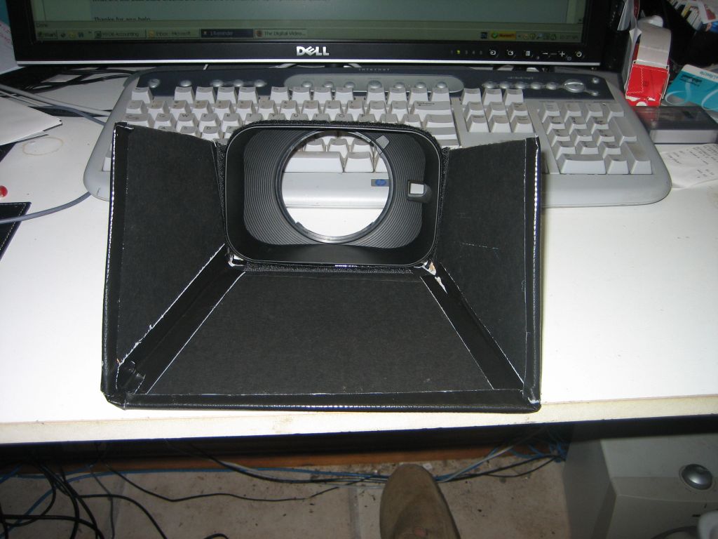

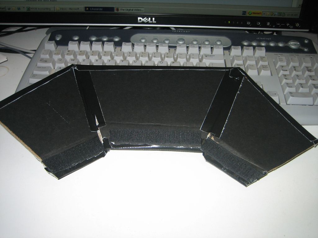

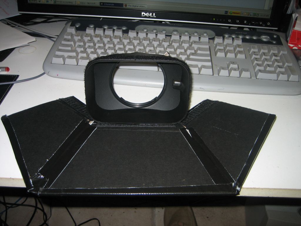

I've been looking at Matte Boxes for a while and decided that since I really don't need filters (I'll use screw on) - I'd just make one.
It's cardboard & gaffer tape - does it work? - YES - does it look good? - only from a distance

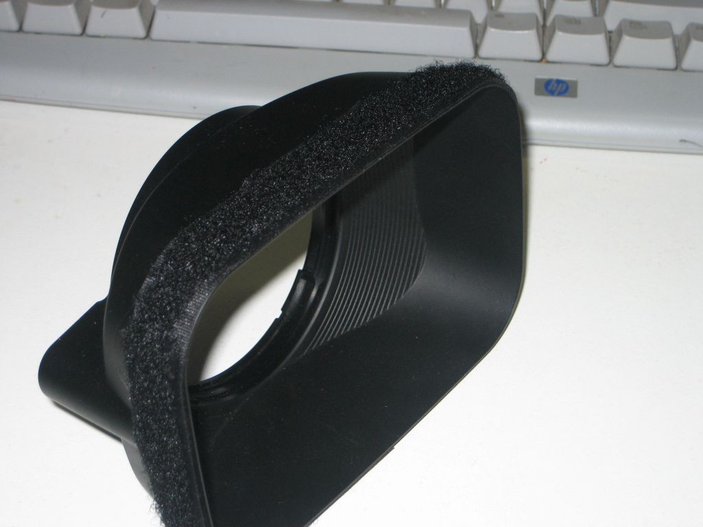

I'm using the lens hood from the XH-A1 with some velcro and it does the job.

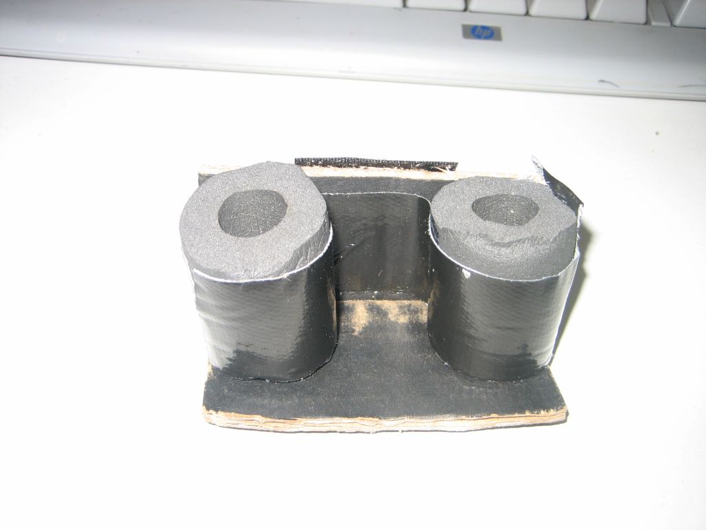

I've also got a LEX with 4 Canon FD lenses and I've made the same unit work for this with another cardboard attachment for the bottom of the hood which fits on the rails.
It's not very elegant but it does the job and leaves me some cash to spend on other things.
For the monitor I got a 7" LCD off ebay for $70 - no good for focus but very light for on-camera / crane and fine for framing. The resolution was quoted as 1024 but it ended up being 480x234 - dodgy ebay sellers! - still the price was right.
So far a decent matte box and monitor?-mattebox-001.jpg   So far a decent matte box and monitor?-mattebox-002.jpg
So far a decent matte box and monitor?-mattebox-003.jpg   So far a decent matte box and monitor?-mattebox-004.jpg
So far a decent matte box and monitor?-mattebox-005.jpg   So far a decent matte box and monitor?-mattebox-006.jpg
So far a decent matte box and monitor?-mattebox-007.jpg   So far a decent matte box and monitor?-mattebox-008.jpg
Cheers - Paul M.

no plans or anything but I'll do you a little step by step video if you like - it wouldn't be hard to make it look a lot more professional

okay guys & gals - here it is
It's quick & dirty but if you refer to the pictures above it should all make sense.
Mine's a little of the rough side but it's just a test and I'll make a better one next time. It's cost me almost nothing and it does the job - it's basically a shade, a bigger lens hood.
For short films and personal projects it's fine but remember I don't do this for a living - I'm not charging. If I were, I'd think about buying a more professional looking unit. Mind you I be thinking pretty hard with the prices they charge.
For now it works, and if I use it till it falls apart then I know I'm getting my money's worth.
http://www.youtube.com/watch?v=b6CxtE-iVug
I think there would also be a way to add adjustable french flags as well - made out of .... I'm sure you can guess
Cheers - Paul M.
