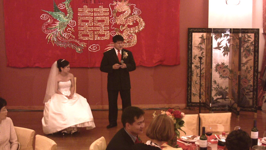

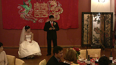

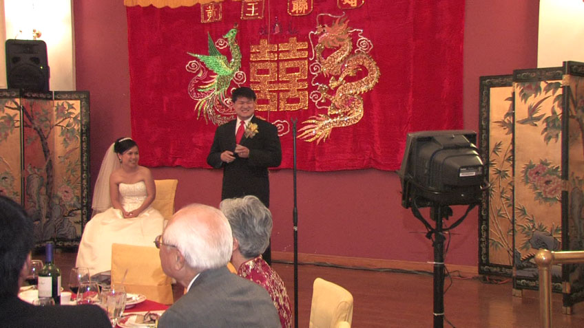

I tried to match the clips from XHa1 and Hv20. Here's my best effort :) Someday I can do better.. just need more practice.
The 3 screen shots attached, one is from XHa1, two same shot from HV20 with and without color corrected.

Getting close Taky...the A1's red is a bit bolder though.

I know I know. It's just very difficult to make it closely matched. Red is very difficult to get it right.. the killing part is the big red backdrop in the back. :(
