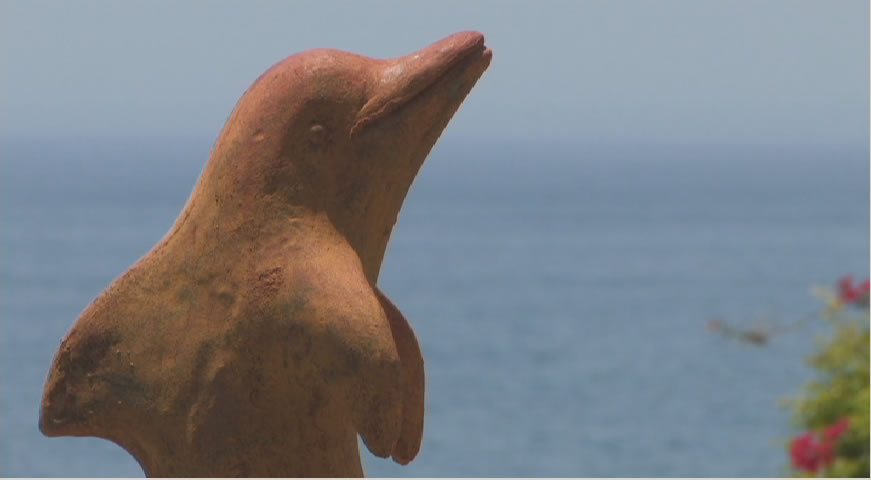

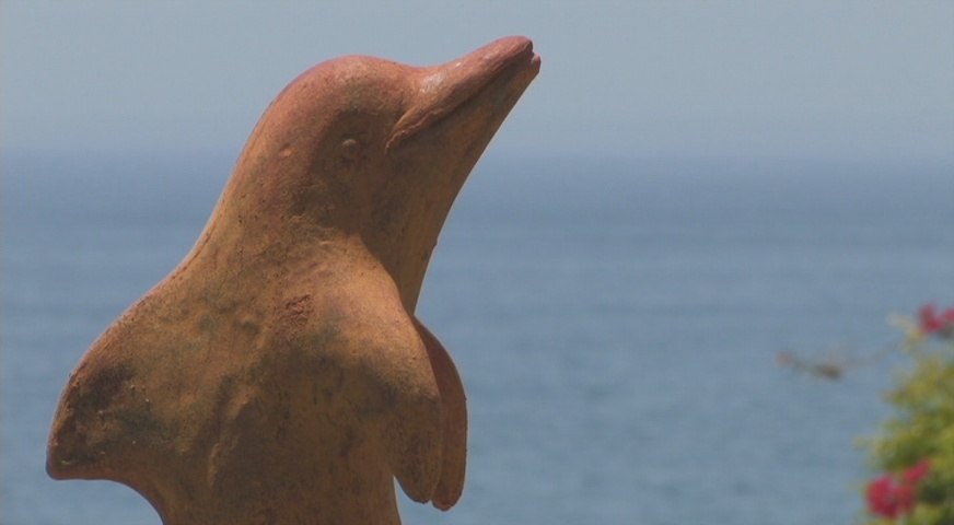

are these final, rendered clips or artifacts that you see on the timeline? i though i had a serious issue as well but discovered that wasn't the case after exporting. i see it only in editing, when vegas stretches the 1440 to simulate device aspect ratio. when rendered, monitored, or reviewed from in-camera the footage looks fine. here's before and after.

Eric Weiss is offline   Reply With Quote
