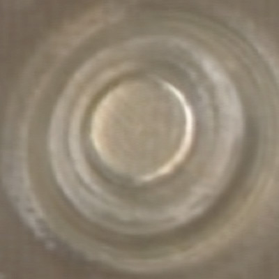

I've been testing just this, but I've found a strange anomaly in the workflow.
If you send clips with "Export > Using Compressor..." from FCP6, then the results of the resizing to 1080x1920 are great.
However, if you drag and drop your captured HDV clips into Compressor directly, or create a Compressor droplet (arguably a simpler workflow for large batches), the resizing leaves much to be desired.
Examples attached (screen-grabs from QuickTime Player at 200%).
Anyone else confirm this?

It's arguably unnecessary to resize to 1920x1080, but I'm testing for some effects shots, so it's just easier to lose the non-square pixels at this stage.
But using the same presets is my whole point. The ONLY difference in those two grabs, is how the file got into Compressor. Compressor setup was identical in both cases, but the results are different. That's what worries me.

Thats interesting about the path to the export .... Final Cut Pro or compressor,Ill have to take a closer look at that one, thats very interesting.

Ben, I posted in the JES thread.. I noticed the same thing with Compressor.. I've only had the poor result, I have yet to try the alternative way to get the fil into Compressor. Pretty poor.. and damaging to the footage! Never would have suspected it'd do this.
My quess is that Compressor really pays attention to the settings of the sequence when in FCP.. what do you think?
