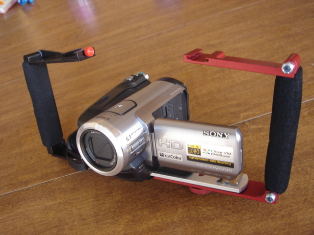

Here's my approach to stabilizing a small camcorder (yeah, I know it's a Sony HC7, but my HV20 isn't here yet... really... I swear you guys convinced me... it's on it's way... but I'm keeping the Sony TOO, OK?).
I've tried about every "affordable" commercial stabilizer out there, still have a couple hanging about as they can be useful, BUT for most average use, this bracket rig works pretty well - sort of a "mini Fig Rig" approach. It's a flat bracket and two folding ones that screw into the flat one (trick is to find a flat bracket with threading on the far end of tripod screw slot as well as the regular tripod hole). This whole thing is pretty compact (non folding brackets are fine, just less compact!) and takes a couple seconds to whip out and screw onto the camera. You can adjust the handles in or out to taste. Takes zero seconds to balance... just grab the handles aim and shoot! If you can drive, you should be able to master this in short order.
Typically I add a LANC controller (that won't work with the HV20... no big deal... just move the right bracket in a bit so I can reach the joystick!), and as a bonus I've got regular full size cold shoes to attach mic, lights, etc... accessories really DO make the outfit!
The brackets lower the Center of gravity of the camera, and move the hands out a bit so you have better control - even with a heavy WA on front, it's manageable - you have a LOT more control with this rig - you can pan, tilt, crane, etc. with ease! With a little practice of the steadicam glide/walk you can get decent results, haven't ventured stairs or running yet, but should be possible. I even turned the rig around and fiddled with that eerie "shooting yourself" trick the other day!
I've used a single ergo handle bracket with a Z1 for the same reason, and the extra hand makes a BIG difference in controlling the camera.
I know that I've spent a ton of time figuring out this setup, and I've seen a few others using a similar rig, so I'm passing it along - it works surprisingly well, and shouldn't cost more than $50 to collect the brackets, less if you use non-folding ones!
This isn't exactly a $15 "poor man's steady cam" but then again it doesn't look like you had an acident with a plumbing truck on the way to your shoot - if you tack on enough "accessories" the small camera even takes on a pretty convincing "professional" aura!
DB>)

Old April 27th, 2007, 12:38 PM   #10
Location: San Francisco, CA
Posts: 38
Dave this really looks great and I'd like to see an HV20 on it. The price really speaks to me as well, I don't need to impress anyone I just need good footage. I had some questions:
1) How difficult is it to fiddle with camera controls with one hand, while balancing only one side of the rig with the other? (For example if you were walking and adjusting settings, you'd need to support the cam with your left arm on the "fig rig" handle and adust the camera joystick with your right arm) It seems the one-handed steadicams center your arms and attention in the middle, but I'm afraid this might spread your reach too far.
2) Where did you locate these brackets, some place like a Home Depot or average Hardware shop?
3) Does the manual on the HV20 list the tripod mount's screw size? How did you go about securing the camera to a bracket?
4) This seems ideal with a smaller LCD screen on the shoe above the camera, have you seen anyone with this type of rig attempt it? Have you?
THanks for sitting through my amatuer questions :)
~Stephan

Hi Steve -
1. This is where the lanc comes in handy, BUT if you don't have the bracets too far outboard, you should be able to reach the joystick on the HV20 - I can adjust all the touchscreen controls on the Sony with my thumb while holding the rig steady, and my left hand still on the handle. It's also possible to use the right thumb for record/zoom the same way. LANC is BETTER, but not a necessity in my mind.
2. These are standard camera brackets - tons of different ones available on Fleabay, not all are suitable, but most are way cheap. Main thing is they should be fairly stiff, and clear the LCD... The particular folding bracket in the pic is a Stratos mini folding flash bracket - Google it and you'll find two suppliers (they are hard to find, but only $20 @ new) - the flat one is a Japanese import, I had one floating around, just found another from a vendor on Fleabay out of Texas ($11 shipped), but I'm sure they can be had elsewhere - it's really just a bridge for the other two, but it does have a tripod socket in the bottom of the screw for mounting to tripod or a quick release. The folding brackets can also be used individually, but I like the dual setup.
3. See above - it's a standard 1/4-20, the brackets each have a screw - the outboard ones mount to the flat, the flat to the cam.
4. If I had one, I would do it! Main thing is too much weight up top can be an issue - with a 20w light and big SQ91D battery, the CG (center of gravity) goes a bit squirrely, but still manageable, with a mid size battery (SQ71D) it actually serves to counterbalance if you have a WA lens... You could also possibly add some weight to the bottom of the rig via the aforementioned tripod screw, but keep in mind part of the ease of use of this small rig is the light weight - load it up too much, and it sort of defeats the purpose <wink>!
Now that Steve has suggested a cool new accessory..... anyone know where I can get a cheap 3.5-6" widescreen with decent resolution???
DB>)
PS - should know if an HV20 handles well on this setup next week Tuesday.... I expect it to since the camera is very similar to the HC7 layout - will be testing the OIS especially in view of this and other threads seeming to mention the potential problem - I can say for sure that bad camera technique is not going to fly with HDV.... ANY HDV. My HC3 was not as stable as the HC1 and HC7, and it was tougher to get smooth video, but this rig works well with both of those cams.
