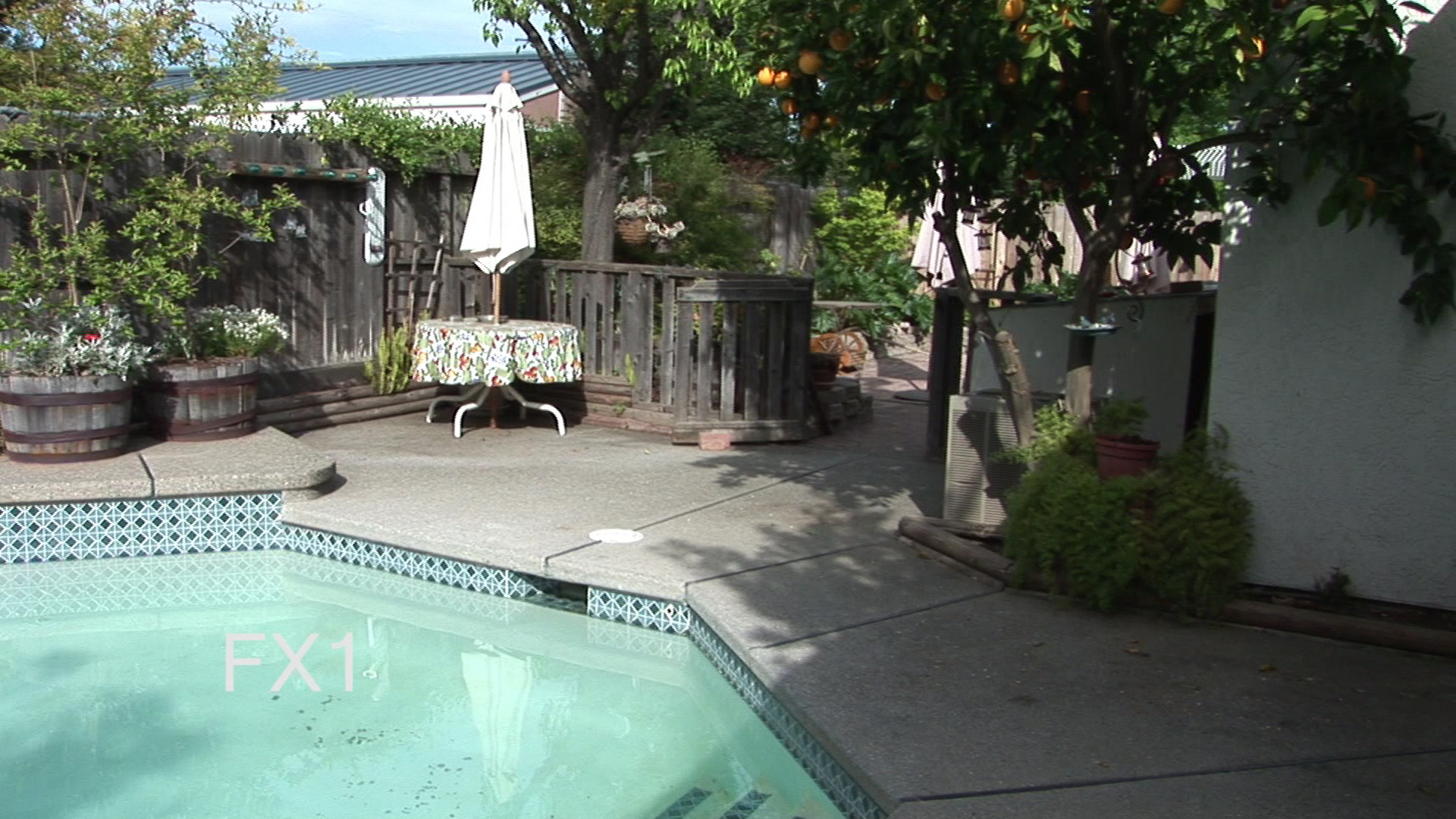

Example of Blowout

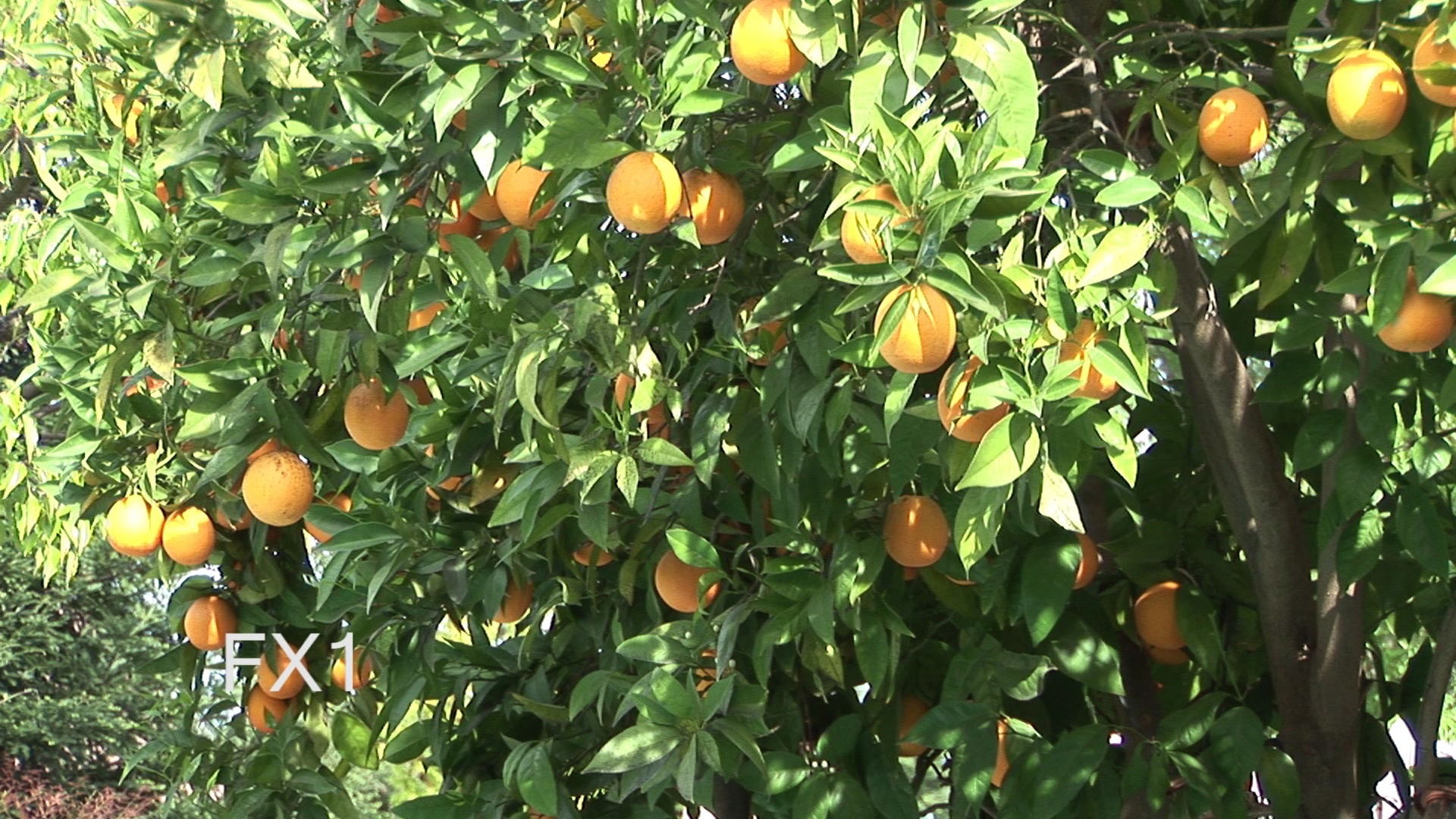

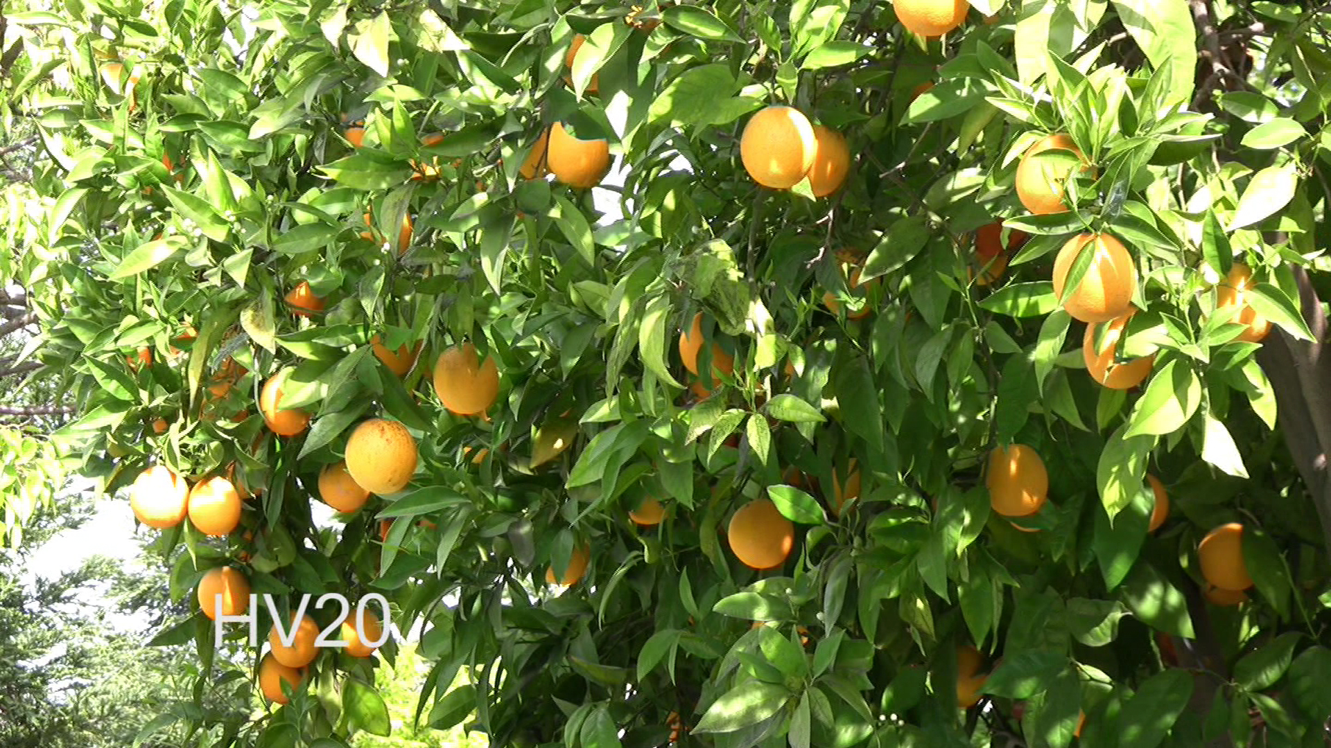

I think the HV20 tends to blow out a bit. This was on full auto with no input. The FX1 is also provided for comparison.
Sony User Tries Canon  HV20-hv20zoomorangeresize.jpg   Sony User Tries Canon  HV20-fx1zoomorangeresize.jpg

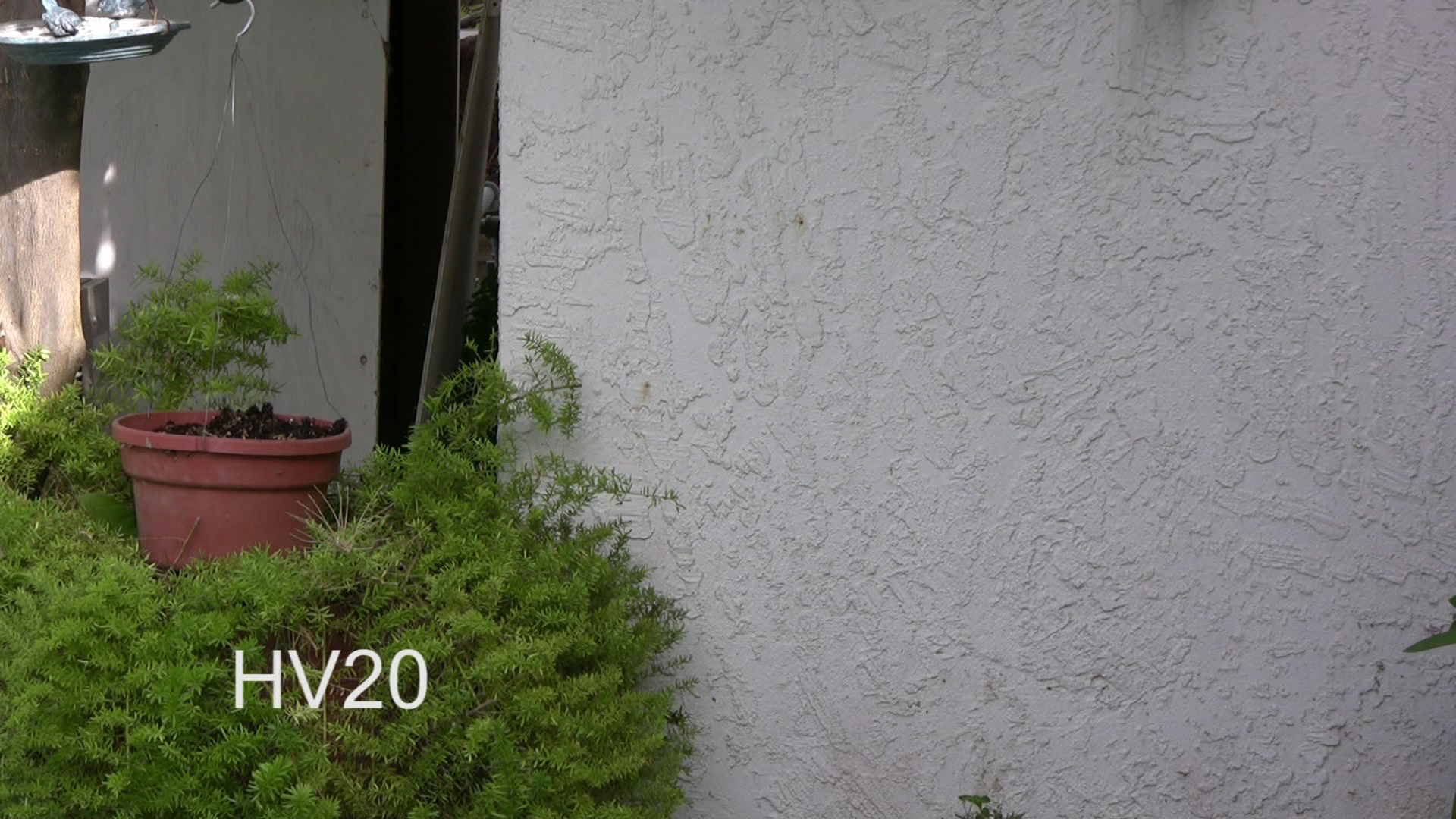

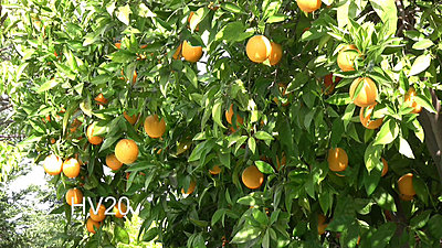

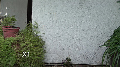

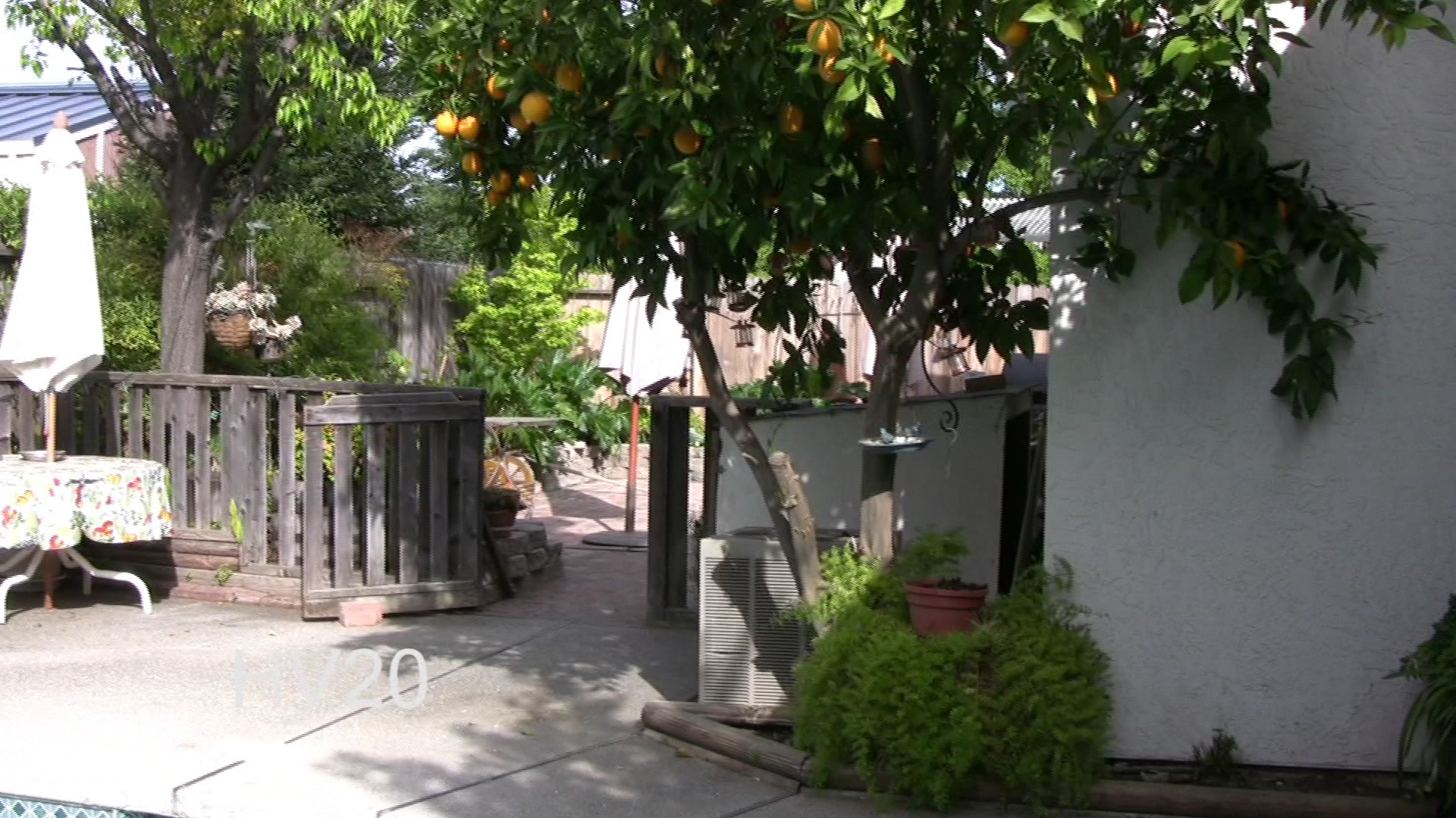

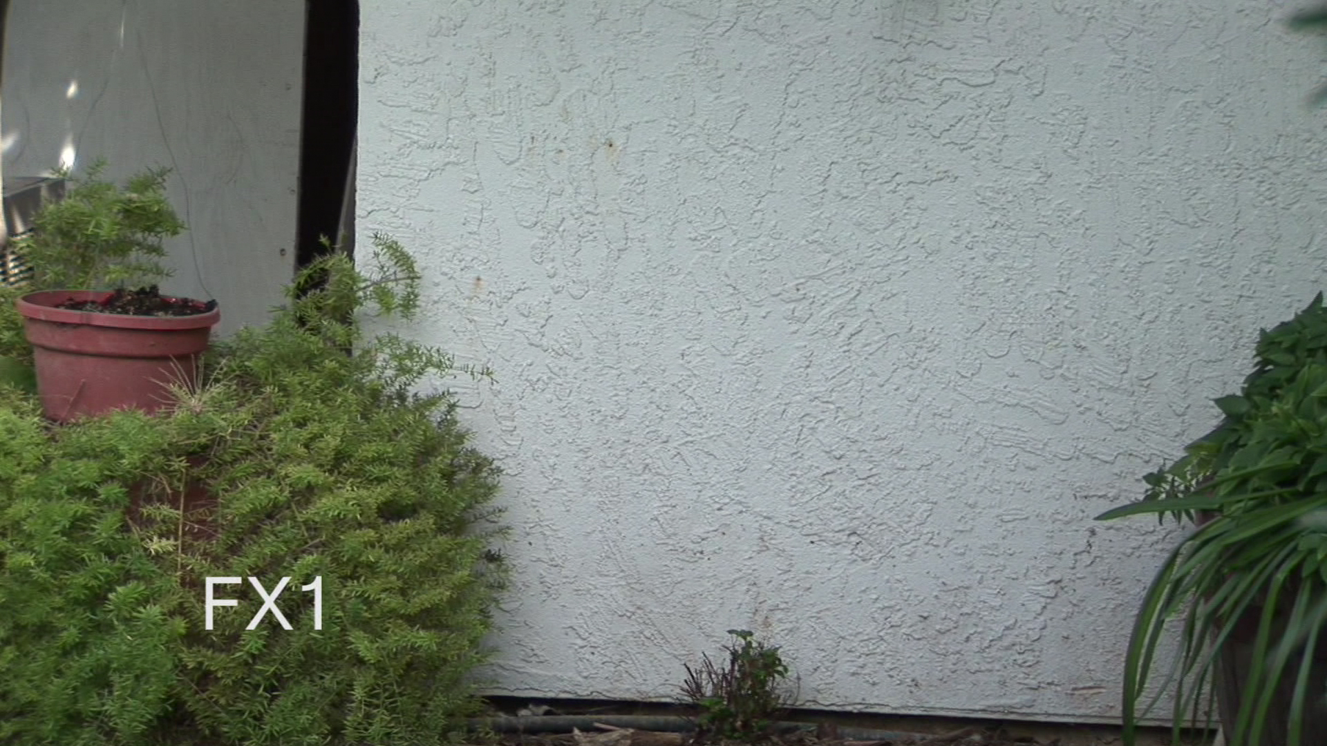

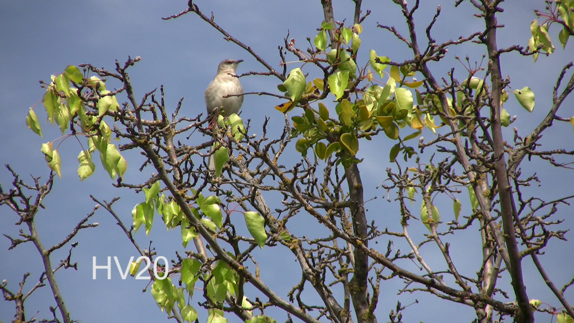

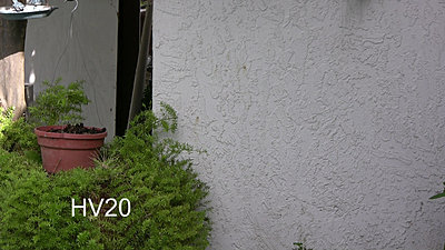

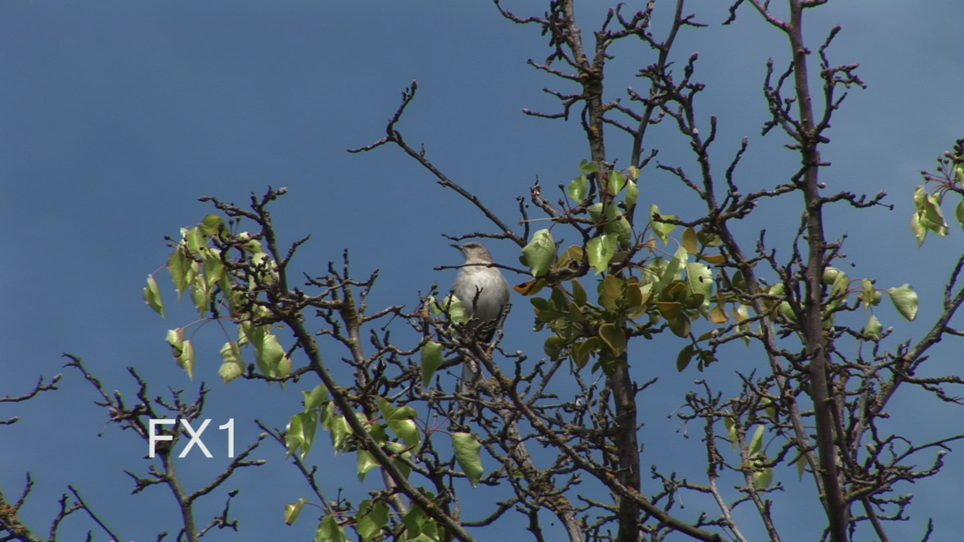

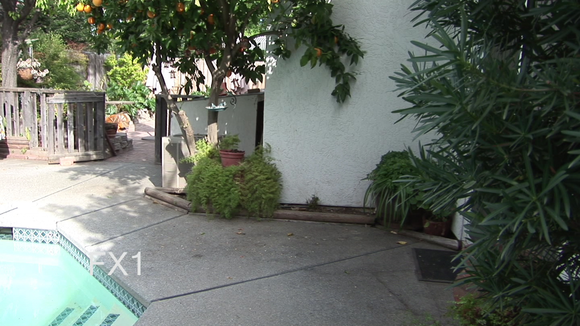

I had to convert and resize all the grabs from .bmps, but are eight more to look at. The FX1 bird picture was actually done with a Cinema effect on, so comparison there is not full auto to full auto.
Sony User Tries Canon  HV20-fx1birdtreeresize.jpg   Sony User Tries Canon  HV20-hv20birdtreeresize.jpg
Sony User Tries Canon  HV20-fx1bushwallresize.jpg   Sony User Tries Canon  HV20-hv20bushwallresize.jpg
Sony User Tries Canon  HV20-fx1orangetreeresize.jpg   Sony User Tries Canon  HV20-hv20orangetreeresize.jpg
Sony User Tries Canon  HV20-fx1poolresize.jpg   Sony User Tries Canon  HV20-hv20poolresize.jpg

Interesting shots. From those shots the color and detail really look better on the HV20, but the FX1 does do a better job holding the highlights.
