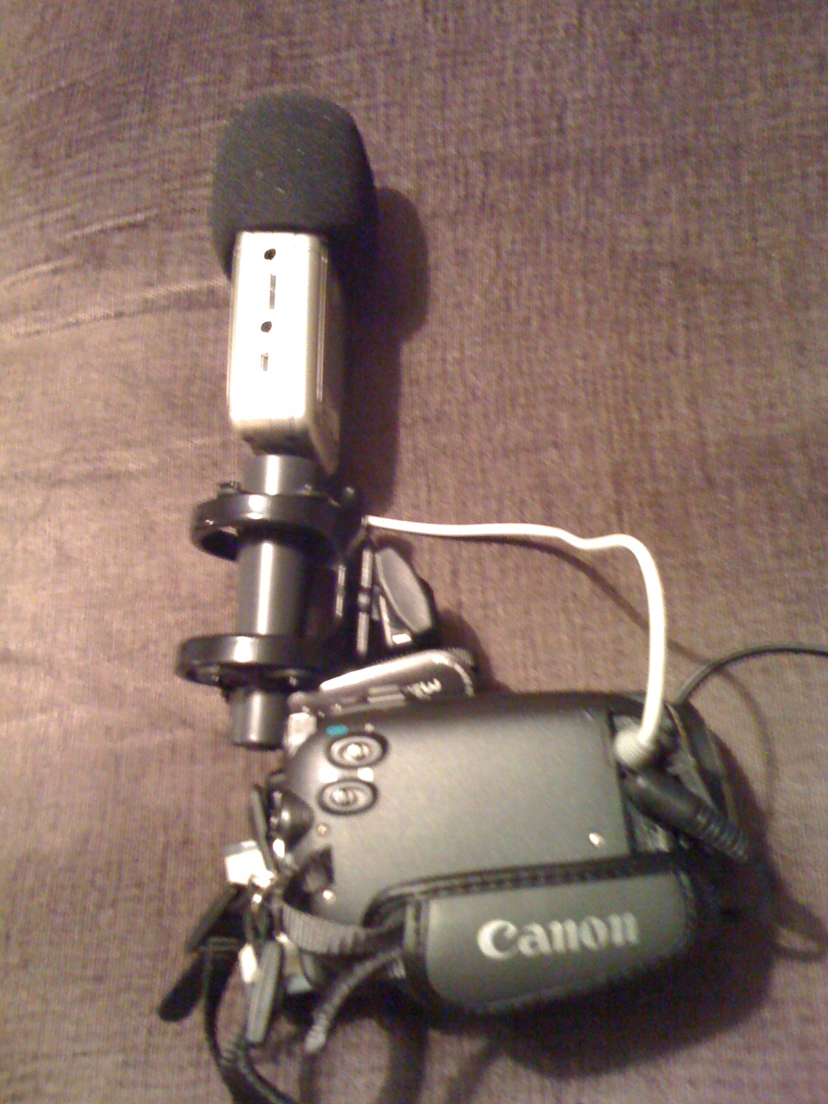

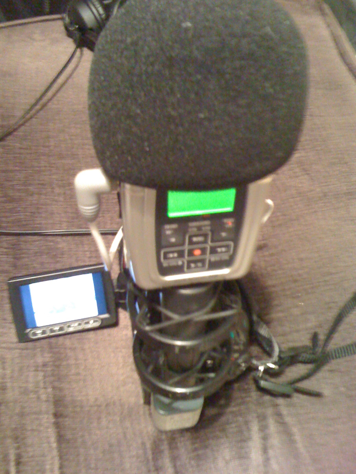

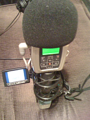

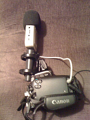

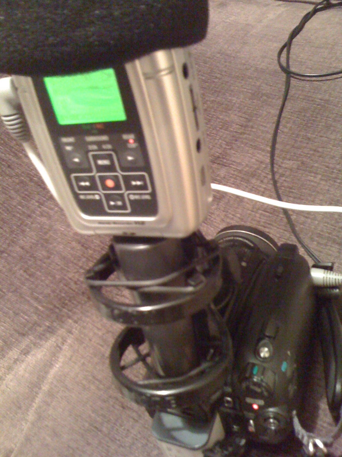

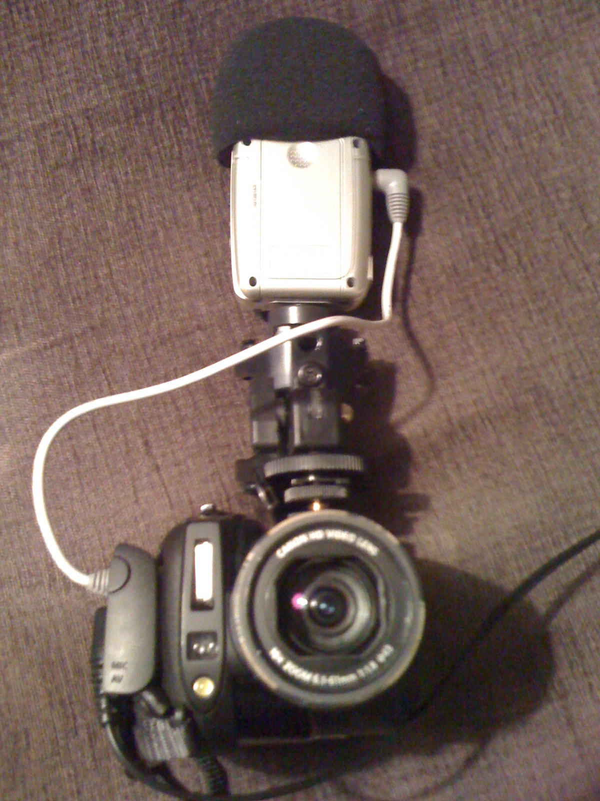

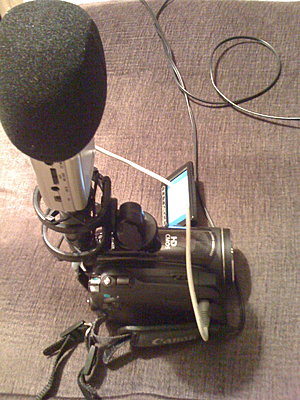

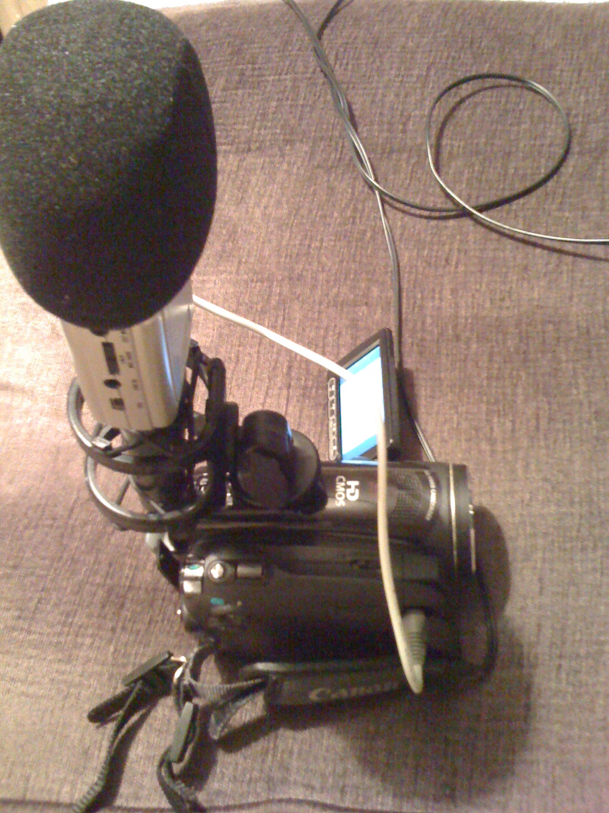

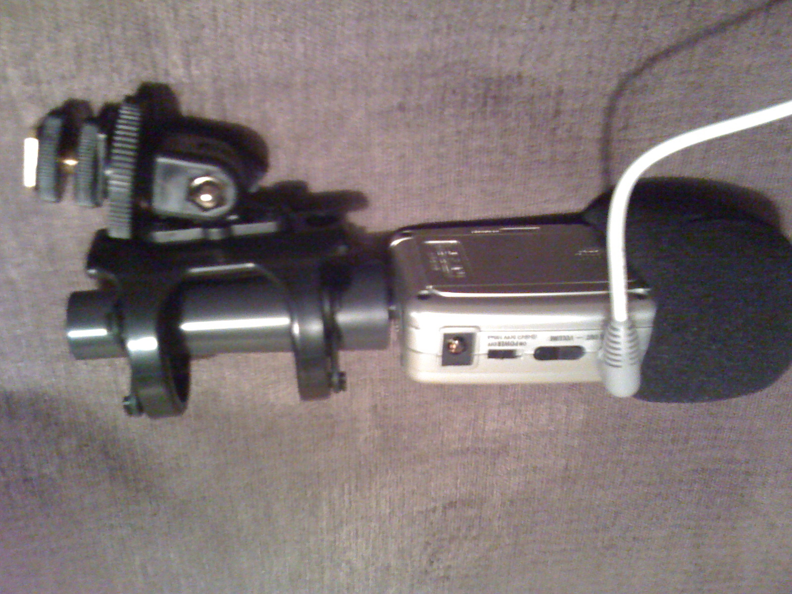

EDIT: OK I tried fitting on the Zoom H2 with a Rode SM3 shockmount plus bits from a Rycote Hotshoe Extender. It looks rather awkward but is quite light and it gives a choice of 90 or 120º stereo settings by selecting front or rear mics, rotating the H2 if necessary. I haven't done a test recording yet but I would need to find the optimal settings to reduce noise on the camera audio tracks. I'm using the line out on the H2 and the mic in on the HV-30, not the ideal match. Of course a recording from the H2 could just be synced on later, but it would be good if I could avoid having to start and stop both Zoom and camera every time. Here's some photos (apologies - just from an iPhone) The last one shows details of the mounting.
