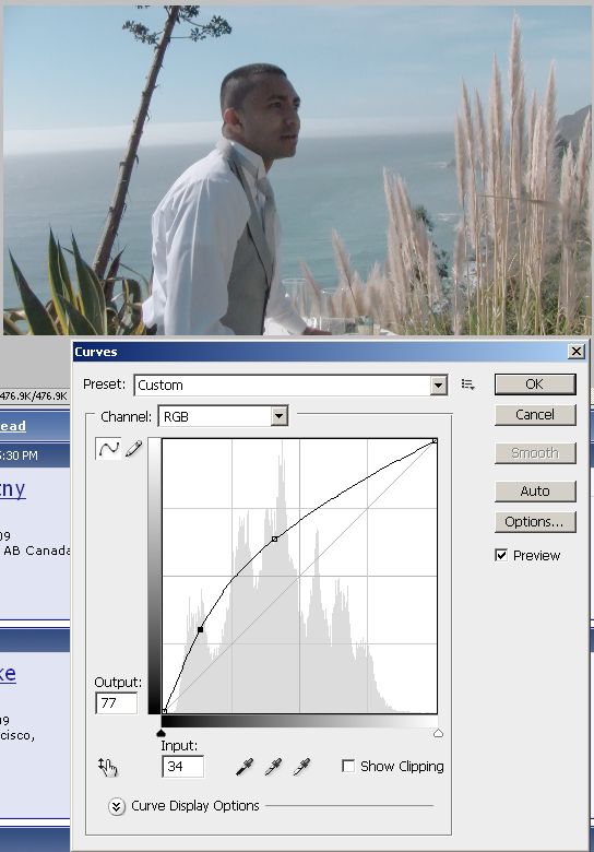

I don't know exactly where this feature can be found in FCP, but I took your image and adjusted curves in Photoshop. I believe Colour (part of FCP studio) should have a Curve adjustment tool that will do what you need.
You'll need to do some research on this, though.

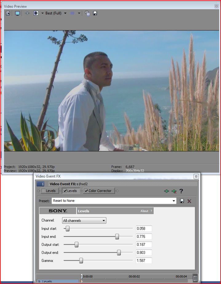

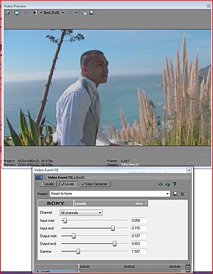

Adjusted same pic with Levels in Vegas, then pushed saturation up a bit. See pic attached.
