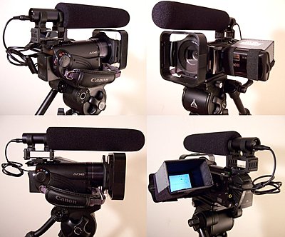

Originally Posted by Stefan Immler View Post
I made some changes to my setup:
I added an Azden SGM-X shotgun mic. I picked that mic because it is one of the smallest shot gun mics and has the right connector (mini plug, no XLR). Also, the shock mount fits into the mini-shoe by filing off a tiny amount (about 1mm on each side) of the plastic holder. Since the shock mount has a rubber suspension, handling noise from touching/operating the camcorder is not an issue anymore as the rubber suspension absorbs these vibrations very effectively. I still use the AT Pro24 stereo mic when I need a stereo signal. Both mics give excellent audio.
I also added a Hoodman HD-300 16x9 LCD hood which is fantastic! Shooting in bright day light is finally not a problem anymore. I highly recommend the Hoodman.
A kept the Cokin Series A filter holder (poor man's matte box) and added a few filters. I think the size of the Cokin Series A is perfect for the cam, so I'll def keep it. I might add a second modular hood.
Overall, I am very happy with the setup.
I know it's been several years since this was posted, but can someone tell me which components are needed to construct the Conkin filter holder as seen here?
Evan
Evan Graham is offline   Reply
