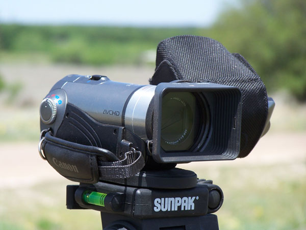

Here's what I use. 37-52mm stepup ring, 52mm UV filter, and Hama hood for 52mm (clamps over 52mm filter ring. Ordered from B&H photo). If I can successfully attach a photo, that is what is shown.
It does block the Instant Autofocus sensor but regular autofocus works, just be aware it may take a second or so.
I find this to be a very effective hood for the lens built into the camera. Any wide angle or telephoto aux lenses will likely require their own hoods. And with this cam I consider a hood absolutely necessary.

Bruce -- that's a sexy looking camcorder you have there! ;-)
What lcd hood is that? I have the Hoodman 16:9, but this one seems to be different.
