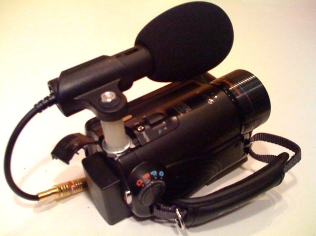

I made my own adaptor from parts that I found in the hardware store. Below is a picture (the mic is not plugged in).
Basically, I put a metric hex (M5) bolt upside down inside the show, a washer on top within the shoe, the same washer on top outside of the shoe, and tightened it with a metric M5 bolt. Next, I was sliding a plastic spacer over it (white plastic), the standard mic holder of my AT Pro24 mic on top, and a washer and a metric M5 nut on top of the mic clip to secure the mic clip. It's rock solid and cost me around $3 total.
Stefan Immler is offline   Reply With Quote

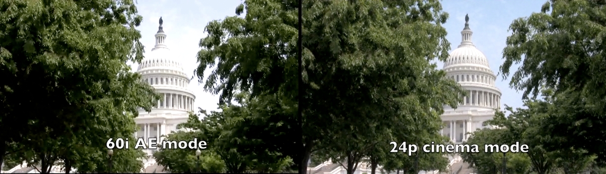

Cinema Mode
Here is again the comparison between the standard AE (left) and the "cinema" mode (right). I like the colors and reduced contrast of the cinema mode much more, so the sky is not washed out, and there is more detail in the shadows.
Would P-spotlight have helped 60i mode on the left?
Brian W. Smith is offline   Reply With Quote

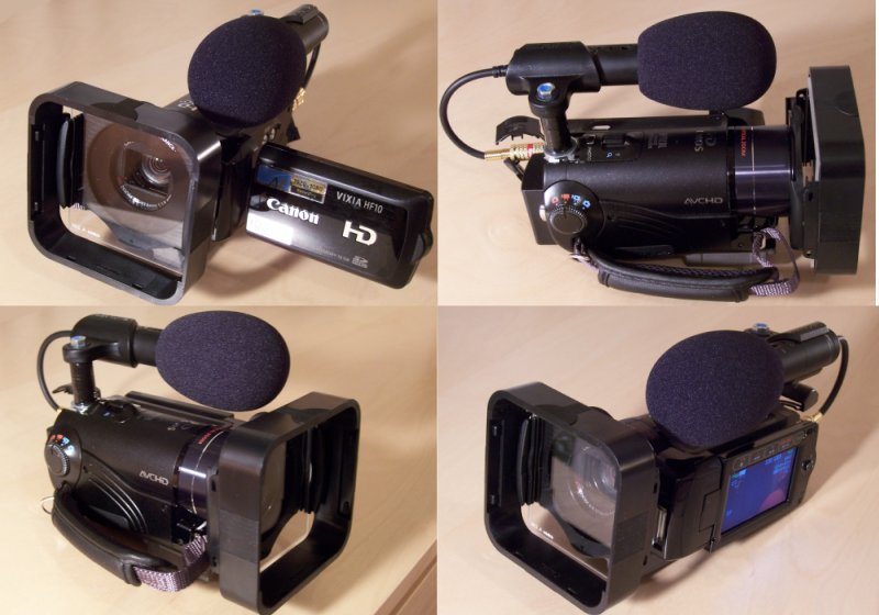

Here's how the HF10 looks like with a Cokin Series A filter holder and an AT Pro24 stereo microphone.
