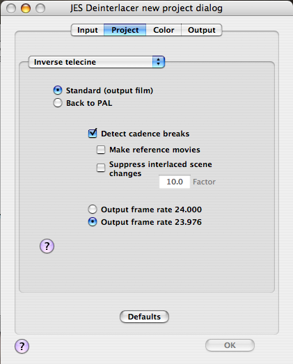

I have also tried it with several different codecs, all of them yield the same result when rev. telecined in compressor. Take a really good look at some of your footage that you have done this process to. I'm curious to see how many duplicate frames you can find. Mine seem to present themselves at random.
JES has worked perfect for me every time and is simple to set up. Here is a screen shot of the adjustments that need to be made in JES De-Interlacer:
HV20 23.98/24P workflow. Frustrated!-jes-shot.png
