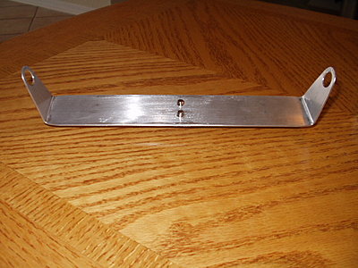

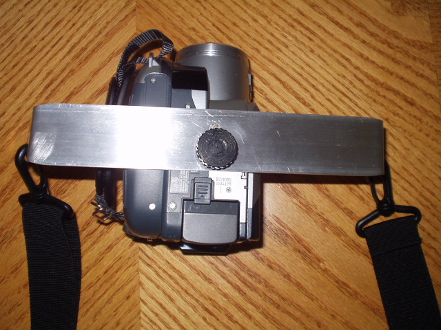

Bracket
Paul,
Threw this together for you this afternoon, to show what could be done. Probably weighs an ounce maybe two. I used a strap off an old bag.
Another approach would be to make a small adapter/bracket that would attach to the hot shoe on top. Then offset it to the right and forward to balance it out.
Sorry for the crummy pictures, especially the mirror shot, but I did not see it as necessary to put a lot of time in on pictures.
Mike

Chapter one, line one. The BH.

Wow, Mike! Pretty nice!
I've found an interim kludge that should work for me. I simply attached one end of the strap to the rear buckle and the other end to the loop formed by the hand strap as it passes through the front attach point. I hold the camera against my chest, one hand on the LCD and the other hand towards the front of the camera. The neck strap provides cantilever support and my hands keep the camera from twisting. The only problem is that the start/stop switch is buried against my chest. I can use the one on the LCD screen, but I'm afraid of premature wear -- too bad the camera doesn't support lanc.
By the way, my HV20 looks really goofy on my Manfrotto 3444D carbon sticks with a Bogen 3160 head. I'll probably look to getting a 700RC2 head (unfortunately, I sold one on eBay a few years ago -- I wish now that I kept it). It's still going to look goofy, though.
