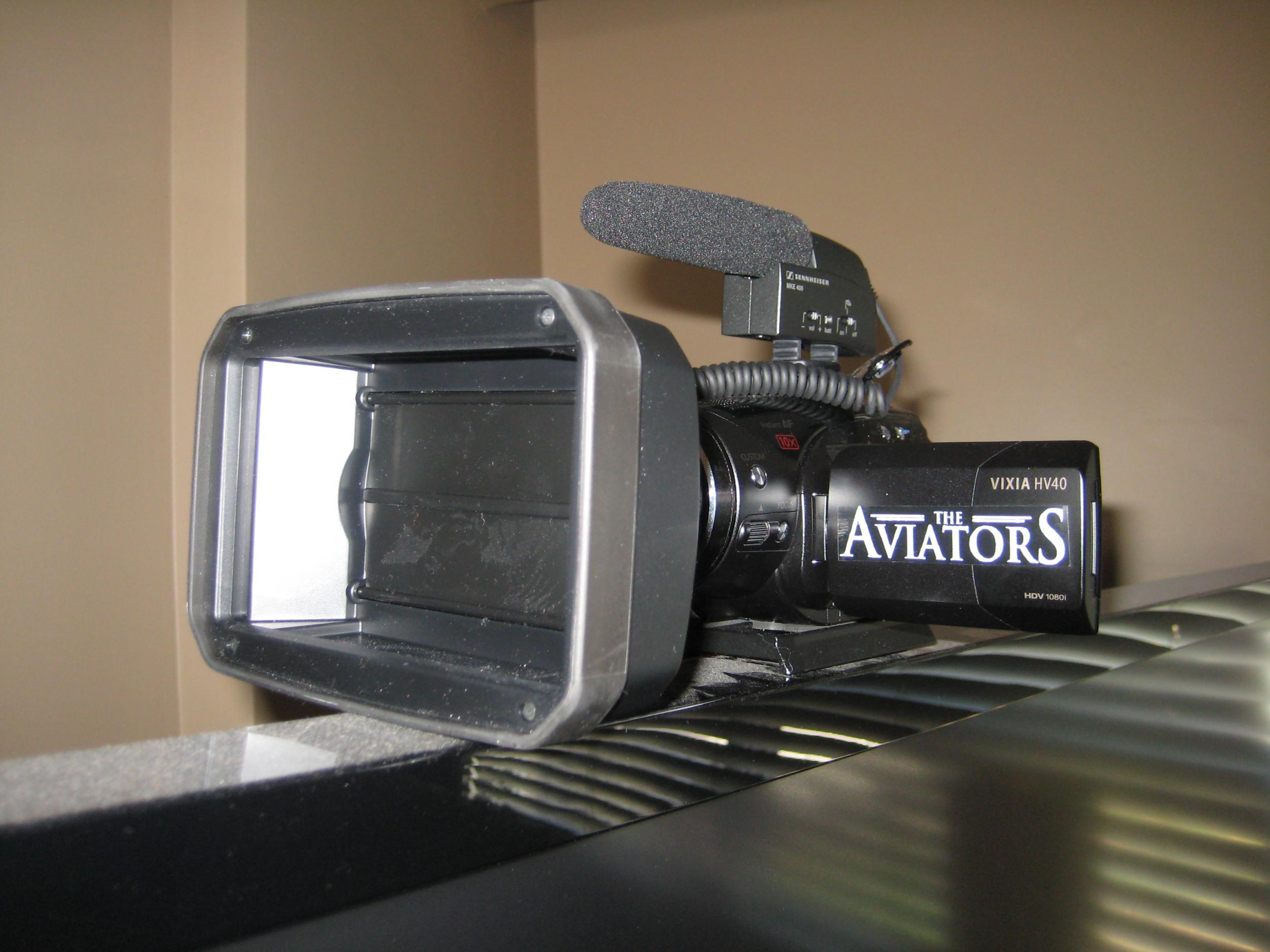

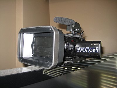

Would you mind posting pictures of the rig with the Z1 hood on it?

Here you go.
Found Lens Hood for WD-H43-img_0260.jpg   Found Lens Hood for WD-H43-img_0262.jpg

Good mod to the HV Anthony, but you can see from your front-on shot how Sony have compromised the hoods efficiency so that it can contain the barn doors shutter mechanism.
If you get hold of a VX2k's hood you'll see the excellent way Sony have shadowed the hood's interior by having a 4:3 mask right at the front, so making the interior of the hood not only matt black but also very often in shadow (so probably 4 stops darker).
Just look at the hood's shutter doors in your photo. Their inclusion means the shadow from the 16:9 mask has disappeared, and to add insult to inefficiency, look at the reflections off the far2shiny shutter blades themselves. The lower one is almost acting as a light diverter, bouncing skylight up onto the front element.
The Z5's hood is slightly improved in that it uses a much matter surface texture to the shutter.
Still, you've done the right thing. What's the vignetting situation like? I ask because the Z1's hood is designed for the much wider wideangle view of the Sony lens.
tom.

As long as the hood is attached perfectly level there is absolutely no vignetting.
Aside from door construct and degree of gloss, how does the Z5 hood differ from the Z1 hood? Would anyone know the part number for the Z5 hood?
