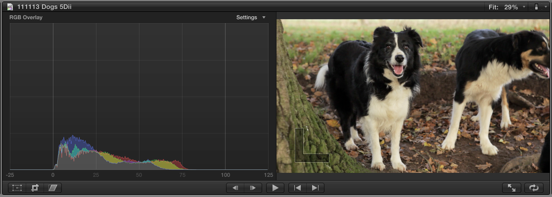

As I said in my previous post, I'm really impressed with the EOS 5D. I'm really hoping it will be a great asset in our productions.
I've found various ways around the difference in ergonomics between the (in our case Sony EX1R) camcorder and a DSLR - and I'm seriously considering investing in the SmallHD DP-6 monitor as focus is critical and as far as I can see, this is the only field monitor of its class with true 1080.
DP6-SLR ? 5.6" Field Monitor
Before I make this commitment, though, I'm still struggling slightly with the very heavy blacks I'm getting with the 5D 2.
Even with contrast, sharpening and saturation turned right down in the menu, the blacks are very black - as the image shows.
As our main 'talent' is sheepdogs (herding dogs) this is a real problem, as the coat detail is often lost and they look like black blobs (often with no eyes)!
Can anyone suggest a possible way to lighten these blacks just a tad?
(Thanks in advance).

This problem is due to the colorspace the camera uses. You are recording in RGB with the Canons which registers black as zero on the luminance scale. When you bring the footage into an editing system if that system doesn't recognize the colorspace as RGB then it clips off everything below luminance 16 (the level for black in the video world).
You will want to look up the best way to import RGB video into your editing application.
I can't recommend more without knowing the details of your workflow and the software you are using.

I'm using FCP X - I just drag the files off the Card, onto my G-Tech HD and then import with FCP X (with no optimising or anything - pure native editing at the moment).
If there's something I can do to help, I'll gladly change the workflow (even the editing software if necessary).

Unfortunately I'm on Avid and haven't worked with the latest version of FC yet.
As a test try one of the free video conversion utilities to convert the 5d files to ProRes and see if you get the same results. You may also want to try QT Pro if you have that on your machine.

The lack of built in NDs on DSLRs really make it a necessity to use the screw on types to get the f stop down to an acceptable level. I really dont like shooting past f/8.
On the topic of the of blacks - it probably depends on the editing software you are using. I have no issue with any clipped blacks on my 7D when editing in CS5 using the DSLR presets. I looks like you are editing in FCPX?

Regarding the color range, avoid Quicktime decoding. The last I checked it messed with the gamma in 8-bit space. That's bad form!
The simplest approach for me is to transcode to Cineform with NeoScene. It's about $100 and has a free license for a week, so you can try it out. It moves the full range signal (0-255) to a ten bit space and sets black and white at typical video levels (64-940 in 10 bit land.)

Mixing DSLR footage with a camcorder like the ex1r will make the camcorder look dull and the DSLR oversaturated without some processing which is best done with custom picture profiles.
On my 7D and my friends 5D we use the Philip bloom recommended settings to tone down the DSLR. There's probably a bunch of threads on settings for the EX1 to make it match. I've got my XF300 dialed in and the 3 cameras match really well and allow grading to be performed with ease.
I suspect that in addition to the gamma issues in converting for FCP, you would benefit from the adjustments mentioned above. As for footage conversion, I use magic bullet grinder which seems to work well.

Firstly, yes, I have the super ridonkulous deep blacks when I use the 5D as well. That's with a neutral PP set to contrast all the way down, sharpness all the way down, saturation -2. Granted, I've been shooting a SUPER MOODY MOVIE, so that's not the best way to judge. I'll have to look at the scant few brightly lit/daylight scenes we have and see if it was an issue.
Are you guys saying we should be doing something with the footage other than converting via 5D2RGB (or similar) to Prores files (for FCP editing)? and then proceeding?
Also, we have been judging footage on set off an SD Sony production monitor, via the AV out on the 5D, calibrated to bars from my XL2. Not an ideal solution by any means, but the one we have available. We sometimes hook up to a PC monitor via HDMI when we're happy with the lighting, to monitor focus. I have noticed that not only do the PC monitor image and the CRT image (of course) look different, they look WAY different. . .PC is much brighter, to the point of noise, and far less colorful. I have noticed the same thing to a far lesser degree when playing back footage from the cam while it's hooked up to my plasma TV. Is this something to do with the HDMI connection vs the AV out? Do they treat color space differently or something?

I've not looked at 5D2RGB since I'm in the PC world but that is exactly what I would use in lieu of QT or the editing system for the transcoding.

The AV Out is composite NTSC where as the HDMI is a digital HD signal. They are quite different. NTSC is commonly referred to as Never The Same Color.
