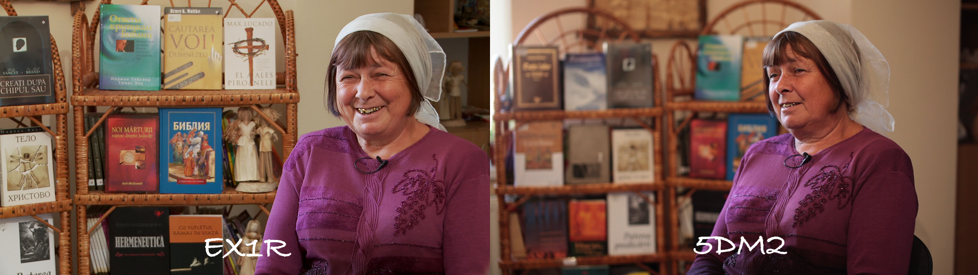

I use the Sony EX1R with the 5DM2 as do a few folks here.
