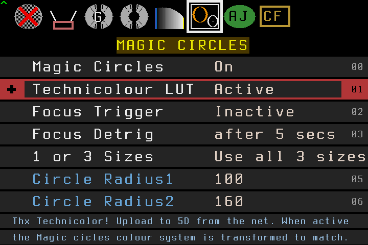

Actually, the first Magic Lantern false colors were incorporated in a version of Magic Lantern being developed by AJ Newman. Alex ported AJ Newman's false color concept to the Magic Lantern for the Canon 5D. If you are going to try the Magic Lantern 5D firmware by AJ Newman, you need to look for this download the AJ5.5 download. He prosted it as a test version under test.zip, but if anyone wants to try it, I can try to get more information. I have been testing, and it is spectacular, and appears to mimic the Marshall monitor color scheme. This Magic Lantern version also has the typical sound control. It is great for shooting off the shoulder and using a loupe in particular, or in very quick set ups. However, it only operates on Canon firmware version 2.04, which I downgraded back to, in order to use it. I do not miss the higher version of firmware.
The way it is set up is you turn it on in the Magic Lantern internal menu, then simple click the "joy stick" button to toggle on and off.
Menus are pretty too. See pic below.
