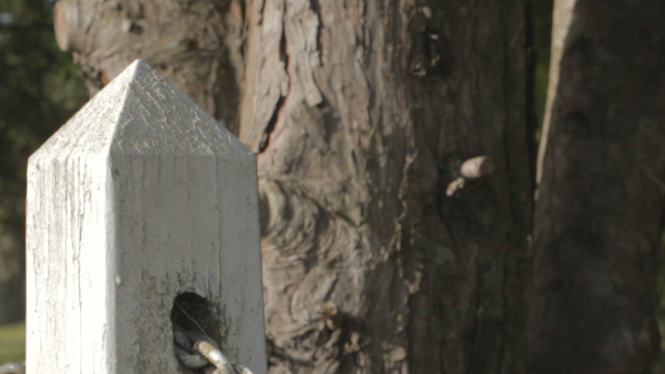

So the technicolor cinestyle is now available. You can dowload it here-
CineStyle Downloads, CineStyle, Digital Printer Lights - Technicolor

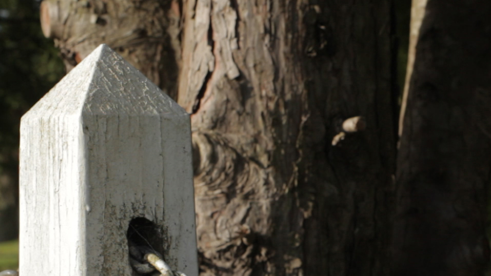

Aside from the tests that I've seen elsewhere what my own testing has shown me is that the picture style retains much more detail around highlight areas that either blownout or close to it. The following is a video and couple of cropped frames from it. They compare the cinestyle with the neutral profile. In both cases the user defined settings were 0, -4, 0, 0. In the second shot (see stills) parts of the post on the left hand side of the frame were blowing out, but you'll notice with the cinestyle there is much more detail around those blownout areas. Its obviously better if you click through to vimeo to watch this in HD.

Your test actually shows vastly improved shadow detail more than improved highlight, which is what I'm finding with this new low-contrast picture style.

Thanks for posting. Seems to be a large improvement. The blacks are often quite crushed with this camera and it looks like the new style really helps in this area.

Also..I'll like is this example above..how will you grade the shots and how diferent they'll be from the neutral.... to me that neutral looks very contrasty already..ummm.

Yes this seems to be the case. The lack of contrast with these picture styles will make focusing more difficult.

Yes it is constrasty by comparison. This was however shot in full afternoon sunlight, in situations that don't have as much variation between the shadows and highlights, neutral with -4 contrast can appear quite flat. In terms of grading one of the strengths of this profile that I see is working with tools like Colorista II which has power masks so that you can selectively "relight" a scene. So in the footage posted above you may not want to keep the extra shadow information across the entire frame but you might want to hold on to the moss under the tree while you push some of the other shadow areas towards black.
