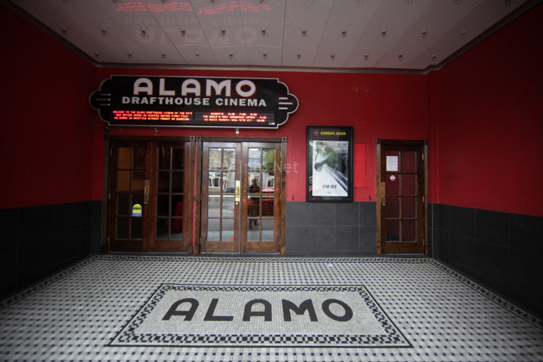

How about the Canon EF 14mm f/2.8L II Rectilinear...

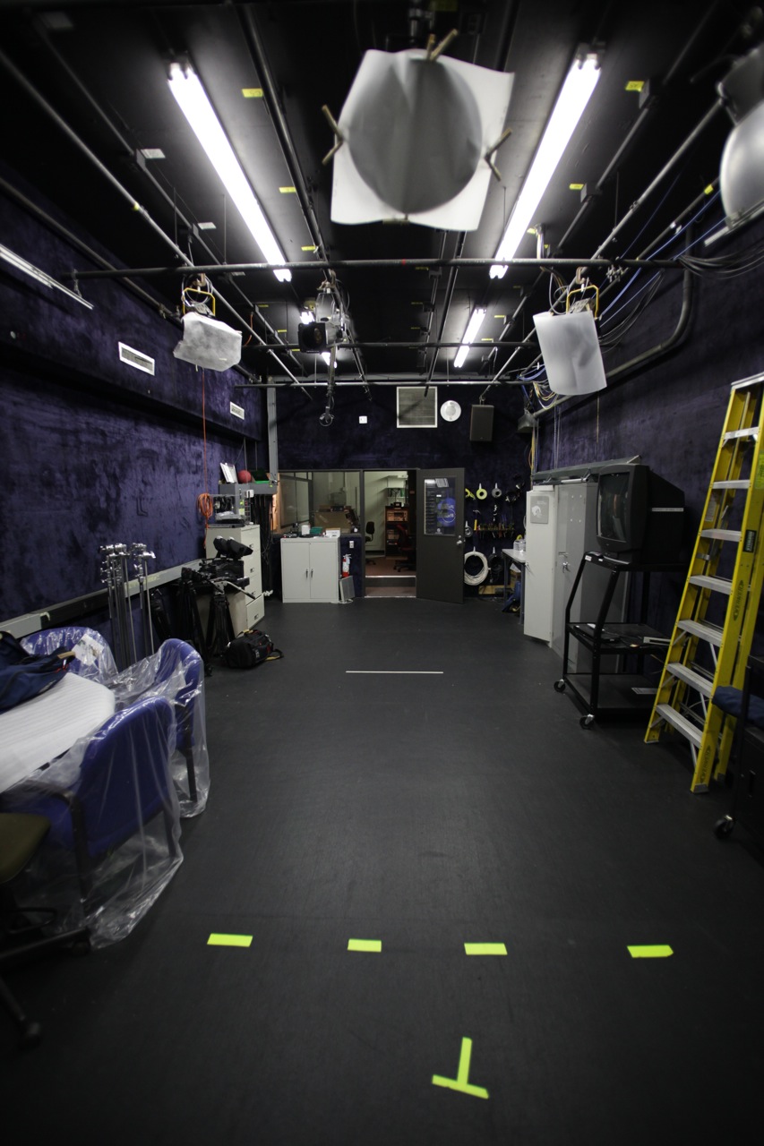

I went with the Tamron 17-35mm f2.8.
I was gonna go with the Canon 17-40 f4,
but the Tamron was only $300 and it was f2.8.
I'm satisfied with it.
Having the f2.8 is nice.
It is soft in the edges but not an issue for video.
For stills it could be, but only if you're really blowing up your photos.
