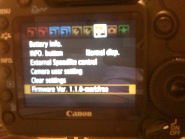

Magic Lantern firmware bootstrapped with 1.1.0
Canon didn't add any protection mechanisms, so it was fairly easy to bootstrap the Magic Lantern firmware onto the 1.1.0 release. I don't have very many functions mapped yet, just the few necessary to take over the camera's init_task.
Sorry for the horrible screenshot; the iPhone's macro capabilities are sub-optimal.
