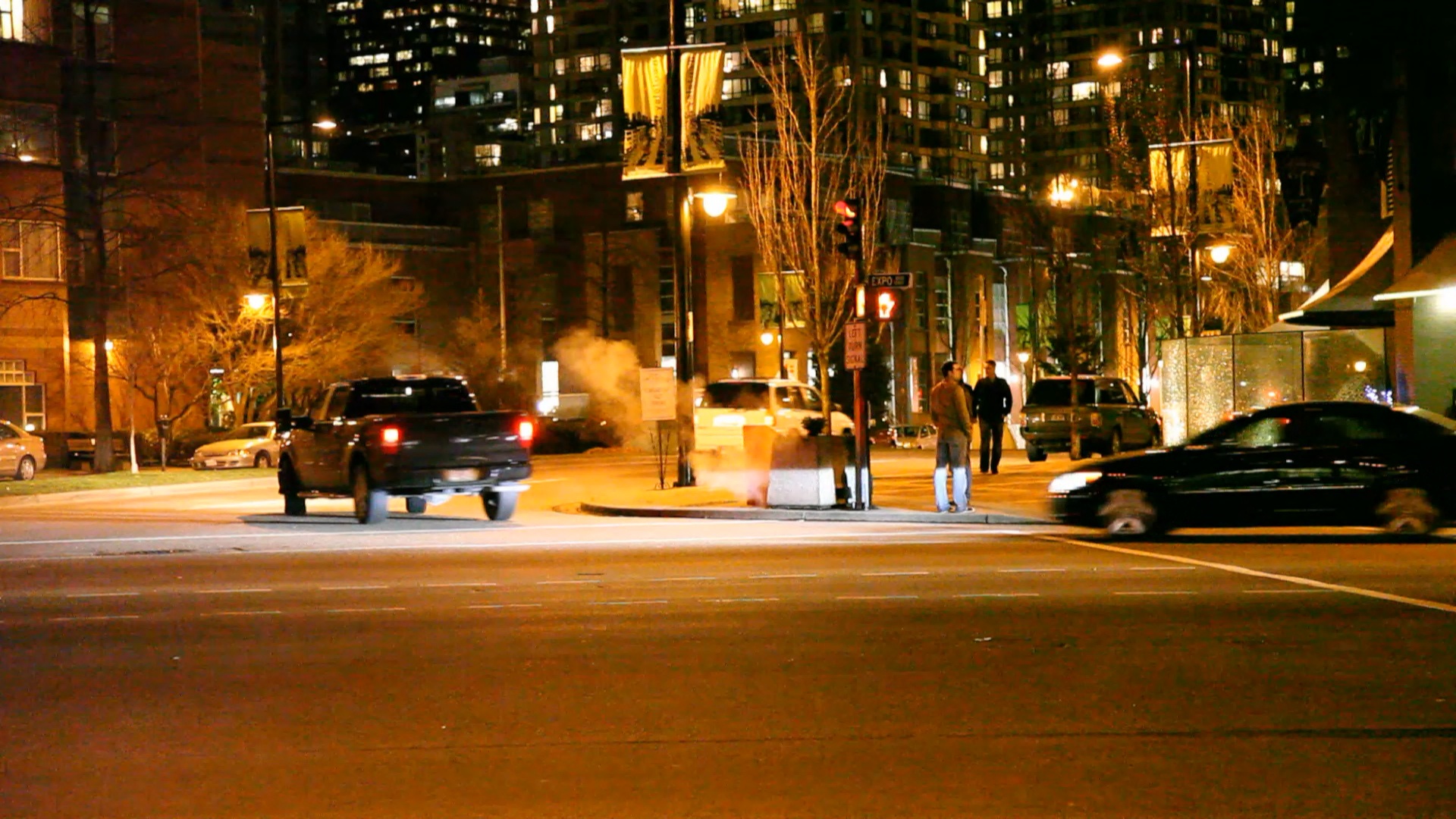

One of the things that impressed me the most about the early 5D videos was the night footage. Mine however, looks like crap. It is muddy, noisy, and filled with the horizontal banding to the point where it is unusable.
Attaching a screen grab so you can get an idea of the noise issue. I'm shooting with settings straight out of the box and the 24-105mm F4 lens. The most visibile flaws (in the still) is the noise in the bottom right section on the road. The moving picture is terrible. Thoughts?

What lens ? What was ISO at, at shooting. Did you lock exposure ?
The first time I shot night, I walked outside of my home and tried to shot toward a street light. I shot full auto. On attached shot, I set camera in locked AE by pushing * button. Then I adjusted exposure wheel to get ISO down to around 1200 or 1000. No more than that, in my opinion.

f4 isn't helping your cause any. You're losing multiple stops of light because of that, which in turn is being made up by the 5D2 by cranking ISO, and thus noise.

I'll second the f.4 thing - my initial reaction was the same as yours, but with an f.2 nikon lens the results were much better. 2 stops doesn't seem like that much difference, but considering what you're really doing is dropping the ISO from 6400 down to 1600 it has a big impact on noise.

I'll try again tonight with my F2.8 and will be borrowing a f1.8 tomorrow, and see what a difference it makes.

Oh, night shoot update: my results with the f2.8 were not really any better than the f4. Watching the info while dialing from F4 back to F2.8, the ISO doesn't change. Still not enough light. I'll be trying it with an F1.8 tomorrow, hopefully it will make a bigger difference.
Dialing the exposure down in combination with the faster lens gives a cleaner picture, I'm just disappointed in how noisy it actually is, compared to what I've seen.
