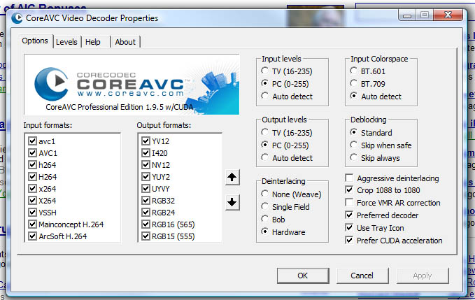

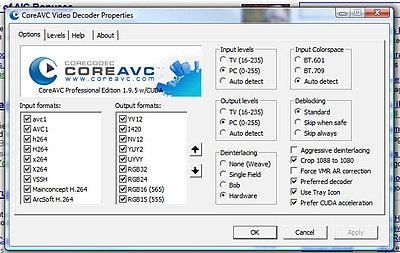

Originally Posted by Jay Bloomfield View Post
I did want to add to my previous post to Thane that the people at CoreAVC also told me that the PC setting is fixed at 709 and the TV setting is 601.
The new version of the CoreAVC decoder (1.95) now has an option that allows you to select the input color space
Jay Bloomfield is offline   Reply With Quote
Old March 17th, 2009, 08:05 PM   #99
Location: Laguna Niguel, CA
Posts: 277
That's great, but it is a bit odd that they let you "auto-detect" the output format. Think about that for a second.
Mark Hahn is offline   Reply With Quote

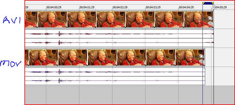

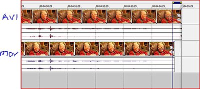

I posted over in the Cineform forum, but I am wondering if others are facing sound synch issues on long converted file. Most of my shooting has been in short 2 minute and under recordings. However, I just happended to shoot a "talking head" shot.
In the .mov file everything is synched perfectly. But in the conversion file, as you slide down toward the end of the file, it gets more and more out of synch. David Taylor suggested that I change playback configuration and I did that, but it does nothing for playing the files in Media Player or Media player classic, or on the Vegas time line. Only way I can fix it is chop up sound track in Vegas.
I am wondering if it has to do with frame rate 30 FPS v. 29.97 or some issue like that.
I know there hasn't been a lot of stuff shot of voice and talking heads, because of othersound issues with this camera, but for those that are, have you seen similar issues ?
Chris.. what if you take the transcoded video and line it up with the audio from the original MOV file, does the sync drift still exist?
Old March 17th, 2009, 09:07 PM   #102
Location: Elk Grove CA
Posts: 6,838
Yang: Spot on question. And my look at it tells us a lot ! I put the two on two different time lines.
The .mov clip ends at 4:55;23. The Cineform .avi ends at 4:45;01. That tells me that the Cineform render added 8 frames. That final 8 frames has a noisy but otherwise "no sound" bit of sound track that does not match anything. I am attaching a view of the time line.
The sound tracks from the .mov file and the .avi file, except for the rogue 8 frames at the end appear to match. So at the end of the clip, the cineform video is about 4/15's of a second behind the sound track.

Follow up: On the Vegas time line, I took and readjusted length of clip using the control key, and sliding the end of clip back to where it ended at the same place as the .mov clip ended. At that point, it looks like sound was synched pretty well. Of course that is a fix, but it also means a re-render of the entire time line to get it matched up. And what happens when I use the intermediate in Vegas-- am I back in the same boat ?
