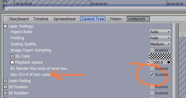

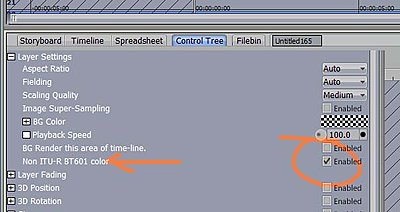

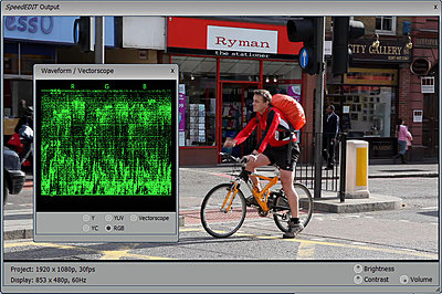

NewTek SpeedEDIT interprets files correctly if anyone is interested. To make the color space fit inside RGB colorspace just check the "Non ITU-R BT601 color" checkbox in the Layer Settings dialog :)

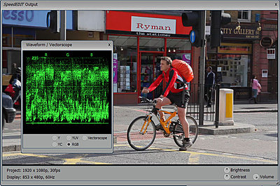

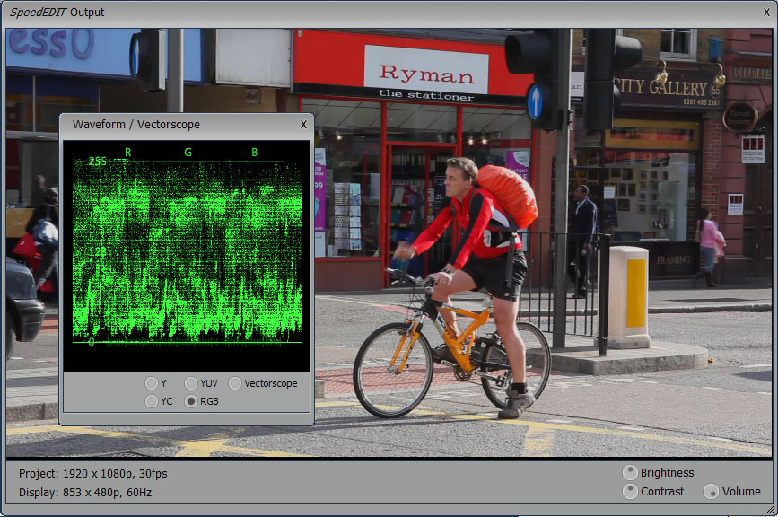

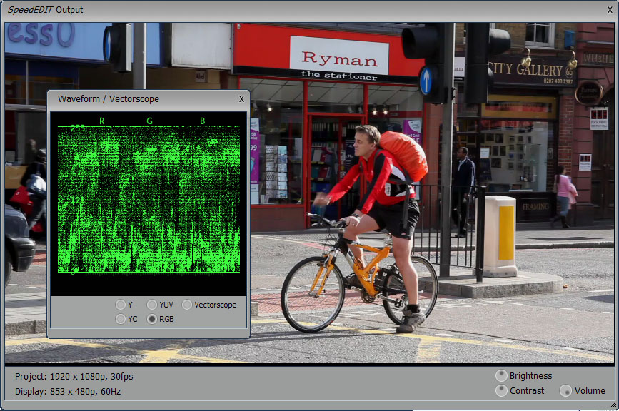

This is what SpeedEDIT looks like when the footage is first imported, the switch to correctly interpret color and the resulting image, all with RGB waveform to verify clipping. The big plus is that you can start editing right away instead of waiting for any transcoding, not to mention the quality hit/extra space.

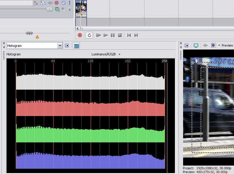

Ok so what does this mean? I'm confused. I dropped the raw 5D file in, set my project properties to match file...? I don't see any weird spaces in my histogram. Am i doing something wrong?

Mike, I saw the same result (no gaps) at first. Make sure that your project is 1920x1080 and that your preview is Best and Full. Otherwise, Vegas will do some filtering and smear the values. Even without the gaps, you can see the peak at black.
