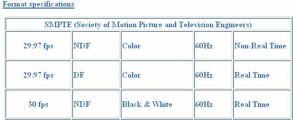

Post removed! Sorry:)
When i read or hear 30fps i automatically think 29.97 non-drop frame... but the 5d is in fact true 30fps --- VERY VERY SORRY! All this time i thought it was just NTSC non drop frame.
Sorry - Sorry - Sorry

First, to Salvador, Jon, Bernard and anyone else, my apologies for being confused and formerly posting wrong info regarding time code and the 5D. I’m reading too many threads on too many forums!
As for converting 30p to 29.97 do you complete your edit at 30fps first then do your conversion OR do you covert your clips to 29.97 and then edit?
BTW having my eyes opened to the fact that 5D is in fact true 30fps and not 29.97 non-drop, is to me more of a pain in the ass than all the other problems I’ve been reading about and trying to find workflow workarounds for! Sooner or later the ratio of pain-in-ass:beautiful images is going to be too high to ignore :(
