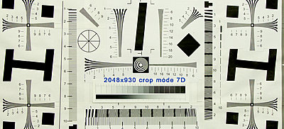

The Canon 7D with Magic Lantern raw video+sound is now maturing as a reliable raw camera, this is how good its 2048 x 930 crop mode video looks like. At 23.976fps with no VAF filter.
At this resolution, the 7D can record continuously at 23.976 to fill up a 1000x CF card.
Sound is sync with no drift. Just nudge it back 1-2 frames on the timeline.
7D 2048 x 930 resolution chart. How good it really is-2048x930cropmodenovaf.jpg

Hi Ted,
Is there a similar resolution chart shot with the 5D2 or 5D3?
The main thing I notice with crop mode on the 5D2 compared to full frame is the noise. I have the EOS-M and it's crop sensor (for photos) is considerably noisier than similar photos from the 5D2. I'm curious to know more about the noise comparison from the 7D to the full frame cams when shooting RAW video.

Right. For crop mode, no VAF, though a full frame test with VAF could be interesting as well.
We definitely see higher noise with the crop modes in our tests. We also see higher noise with Cineform RAW than with more of a native approach. Cineform RAW sure makes the workflow easier though!

I realized how almost all clips from the sample I posted above were soft. This was due to the difficulty I had in getting proper focus using the crop mode. The LV is low resolution/pixelized and not in realtime.
I discovered later that cycling through the info button brings up a clean 5X magnify which I can now use to quickly check for focus.
Unlike the 5D2 that you can use the 10x magnify to confirm focus, in the 7D, pressing 10x magnify freezes the lv so I disabled 10x in zoom tweaks ML menu.
