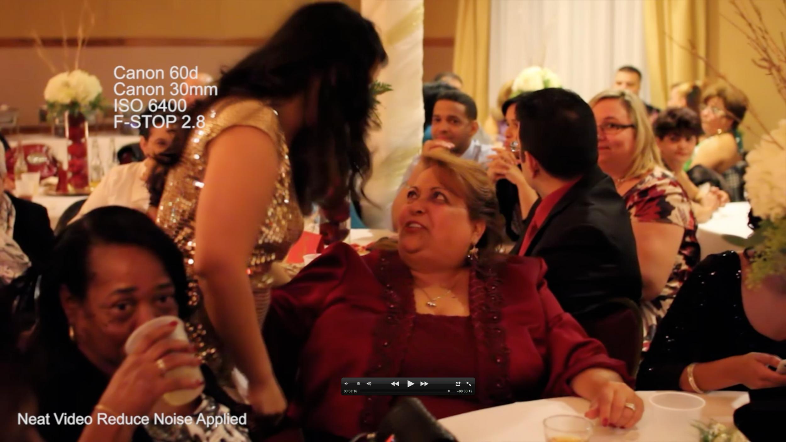

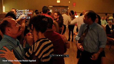

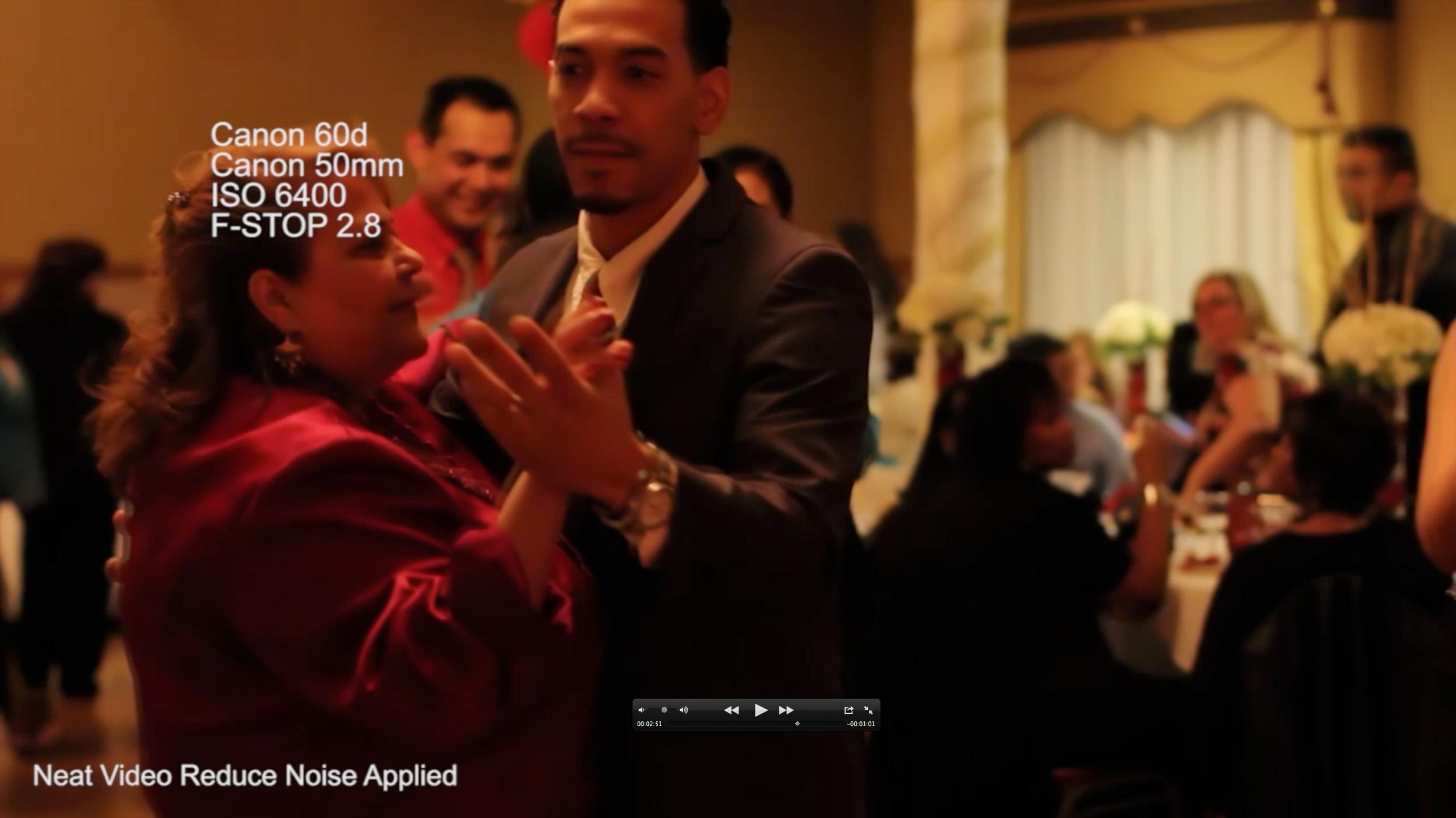

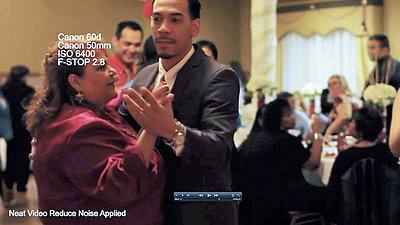

Up until recently I have filmed wedding receptions with the traditional A1s and on-camera light. I see the tremendous potential of the canon 60d, 7d and 5dII.
As I continue to experiment with the 60d during wedding receptions, I feel other videographers are getting better results in low light. I would prefer not walk around with a light on the camera for obvious reasons.
However, my footage is dark, and when the ISO is bumped too high (on the 60d and 7d) the footage is grainy, and I need Neat Video to reduce but also this slightly blurs or smooths over the image too much
For your 60d or 7d, what is the max ISO you will use?
Light or no light for dancing shots (I always use a light for toasts, speeches, ect..)
Shutter below 48?
The F-stop results in too shallow a depth-of-field when below 2.8, where is your f-stop generally at for these types of dancing shots?

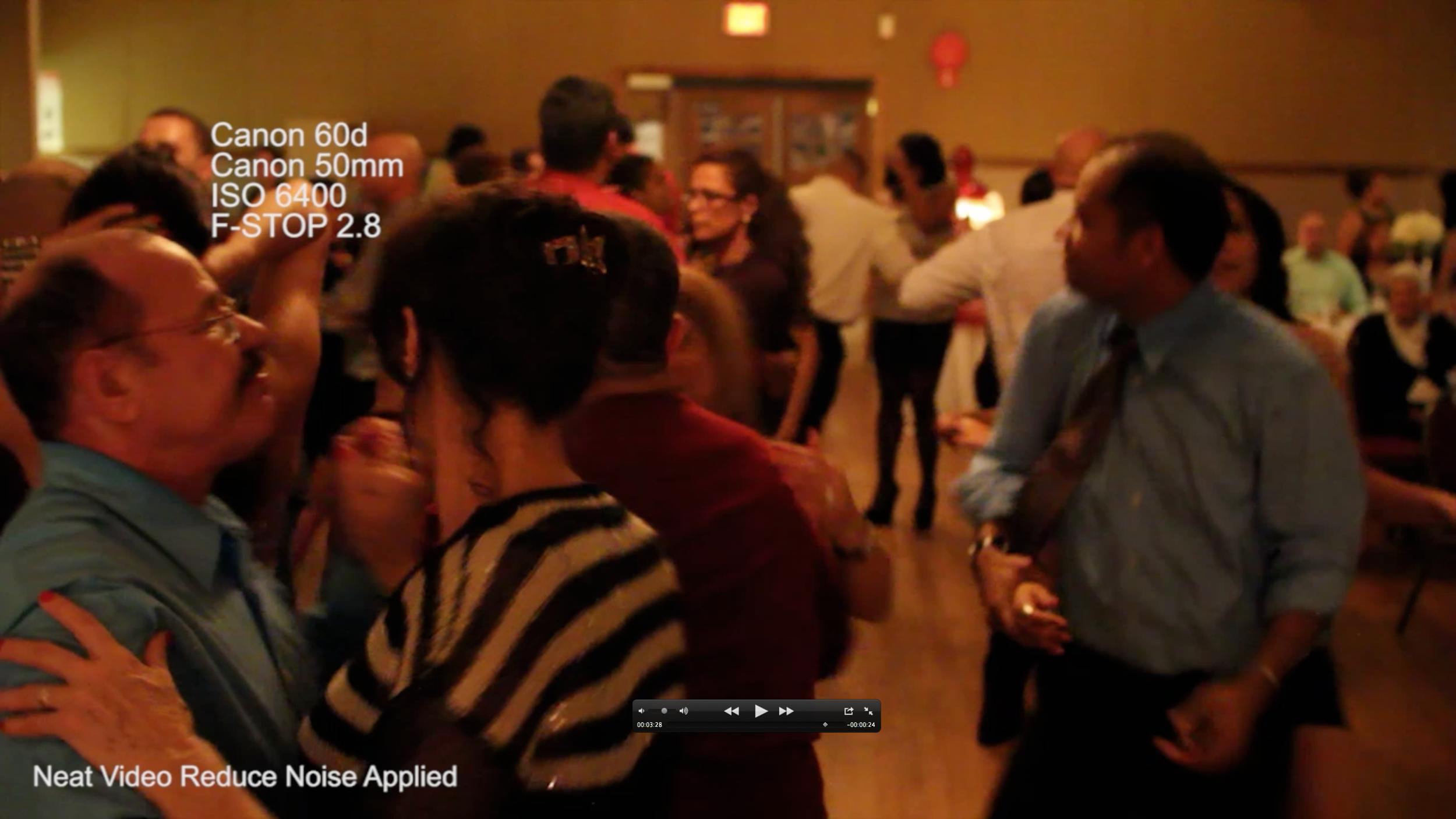

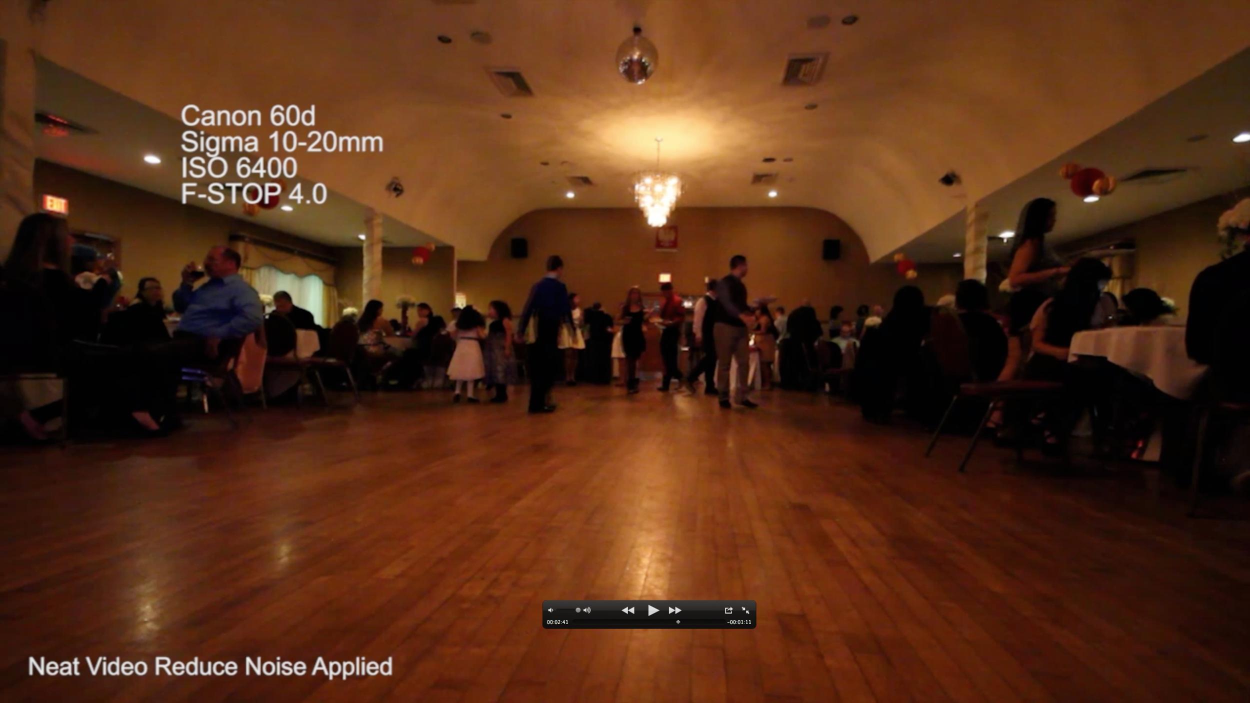

Attaching screen grabs of the 60d with canon 50mm, Sigma 30mm and Sigma 10-20mm. Shutter at 30, ISO at 6400 with varying F-stops. They are very dark, even with the shutter at 30!
Will upgrading to 5DII be my solution to walking around without a light? It looks excellent in low-light.

I will max out my 7D @ 2500. Any higher and the noise starts taking over significantly. Yes, you can massage it cleaner in post, but DSLR footage is soft as it is and denoising takes it further (pushing it further with a USM over top of that stresses the codec even more unfortunately).
The need for more light after that forces me to take off the zoom and put on my 24/1.8. Your screen grabs are what I usually try to avoid as the image turns a bit muddy and loses sharpness rather rapidly.
Now if you have no other option but to crank the iso as you "must get the shot".... then well... you gotta get the shot and expose for it accordingly.

People say shutter speeds below 48/50 are some sort of cardinal sin, but I've shot hip hop dancers at 25 and found it fine. But people say I'm overly forgiving of motion blur.
Still, the way it was described you'd think it was as streaky as frame mode in older canon video cameras and it's nothing like that bad.
I almost never get above ISO 1250, but I find the depth at f2 generally fine. You can't get rid of smear once the codec gets a hold of a lot of noise, so you gotta get more light in there. That's what I say.

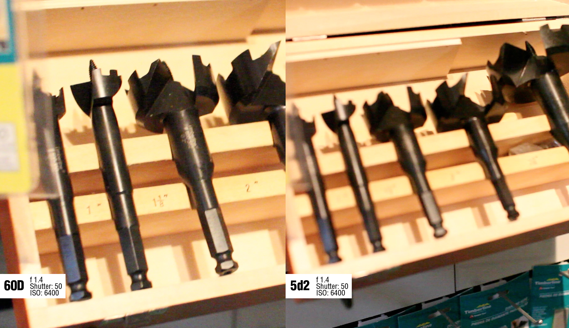

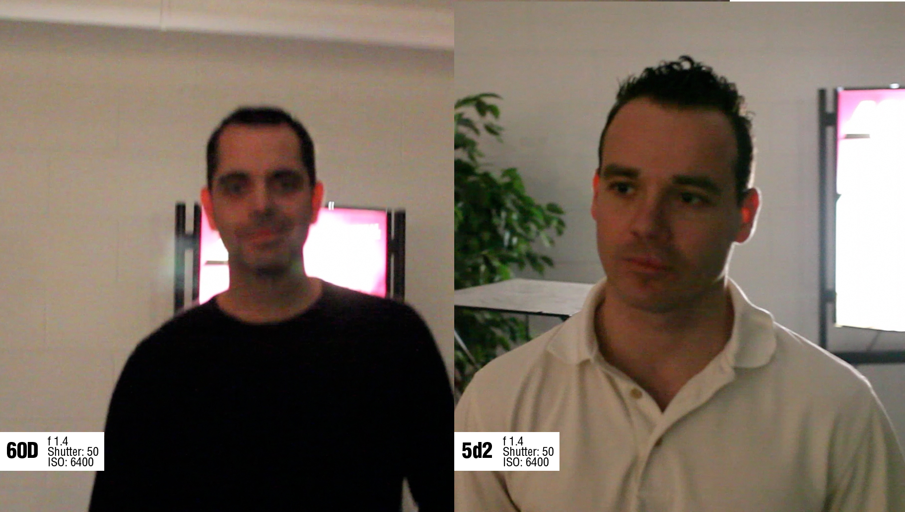

Here's some comparison shots. The 60d was using a Sigma 30mm f1.4 while the 5dM2 was using a 35mm Canon 1.4. (Sorry for the comparison with different glass but was on limited time to switch lens'.)
Conclusion: The 5DM2 is a better low light camera and you can push the ISO higher with less grain.

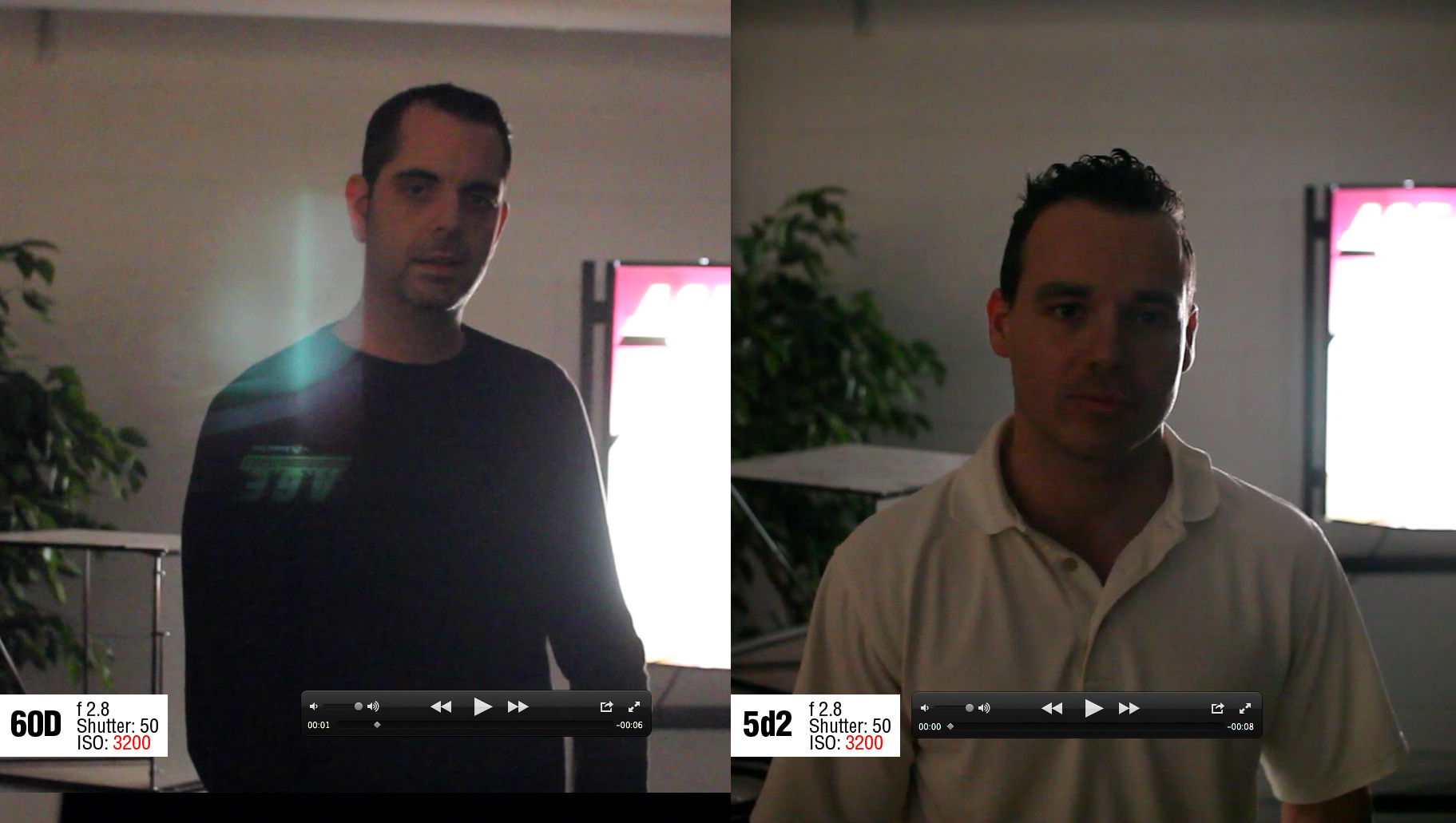

Very true, I'm just wondering if I should upgrade to the 5D2 for the low light benefits, or add a quality light to the top of my 7D and 60D cameras.
Video comparison, here it is: A Side-by-Side comparison on the 60D vs 5DII we shot yesterday.
Lens: Sigma 30mm (yes crop lens but we cropped out vignetting in video)
Shutter: 50
F: 2.8
Canon 60D vs Canon 5DII low light comparison
Thoughts, comments & replies... open to all !
