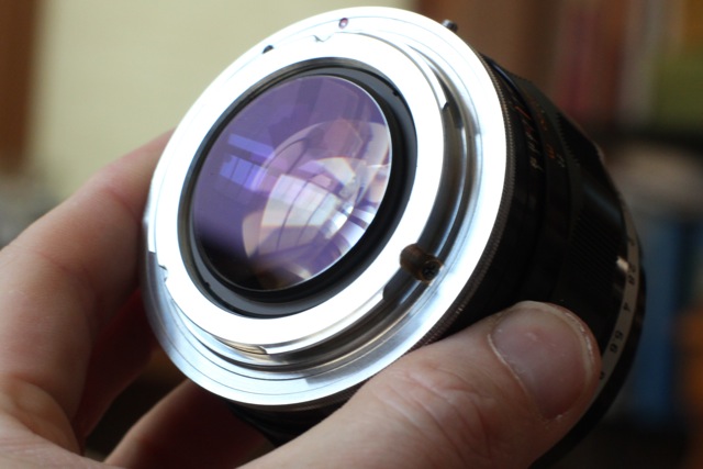

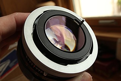

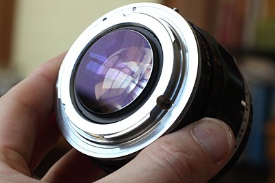

Just a note - Canon FL lenses are apparently easier to convert. I sent a 55mm f1.2 for conversion to Jim Buchanan. Came back looking beautiful. This lens much less expensive than the FD version and is phenomenally sharp at 2.0. It has a click at 1.4 that is useful and 1.2 is there when you need it. The conversion was $125. Before and after conversion pix attached.
FD to EF mount adapter - it's that simple?-img_6729.jpeg   FD to EF mount adapter - it's that simple?-img_6890.jpeg
