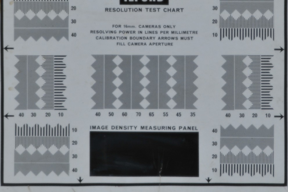

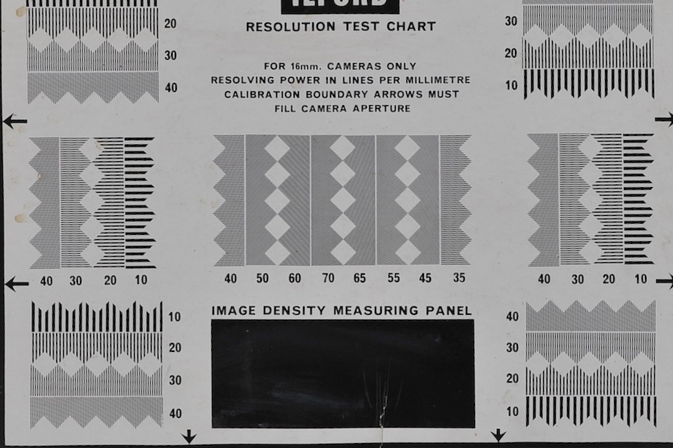

Below are two pictures, the first was taken through a Fotga “Slim wide band FADER ND design for digital camera” variable density filter and the other through a Hoya UV(0) filter that I use as a lens protector. The Fotga is about $20 au including postage.
To eliminate camera movement as far as possible the Nikon D300 was tripod mounted and used in mirror up mode. The lens used was a 300 mm f4 Nikkor and the camera was set in aperture priority mode (f 5.6). The camera set the exposure that varied over an 8 fold range.
I used the full range of Fotga settings and the results were all very similar, i.e. no better or no worse anywhere over the full range.
Apart from the results l Iike everything else about the Fotga. I would be interested in seeing the results from more upmarket filters.
http://www.dvinfo.net/forum/images/a...attach/jpg.gif
Though I my tests were with a DIY vari-nd, it shows the same results as your's with a long lens, mine was a nikkor 80-200 f2.8.
HOWEVER, I found out that mated with the "right" lens, the filter can be consistently sharp at all apertures. In my case a 50mm f1.4 is sharp with the a vari-nd at all apertures and at different filter power settings.
