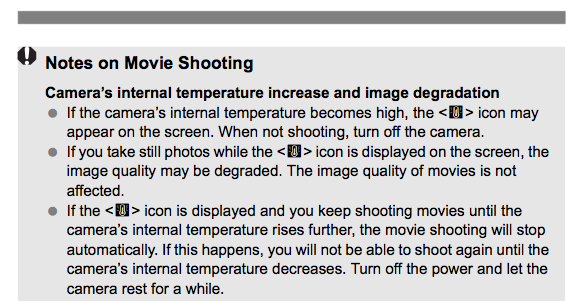

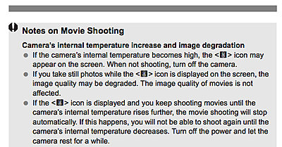

Originally Posted by David Quakenbush View Post
In my experience it does create additional noise in the video. Also, if ignored my particular camera develops a "hot" red pixel that has to be addressed in post.
Interesting. This is from the manual:
T2i / 550D Overheat Test-screencap1.jpg
