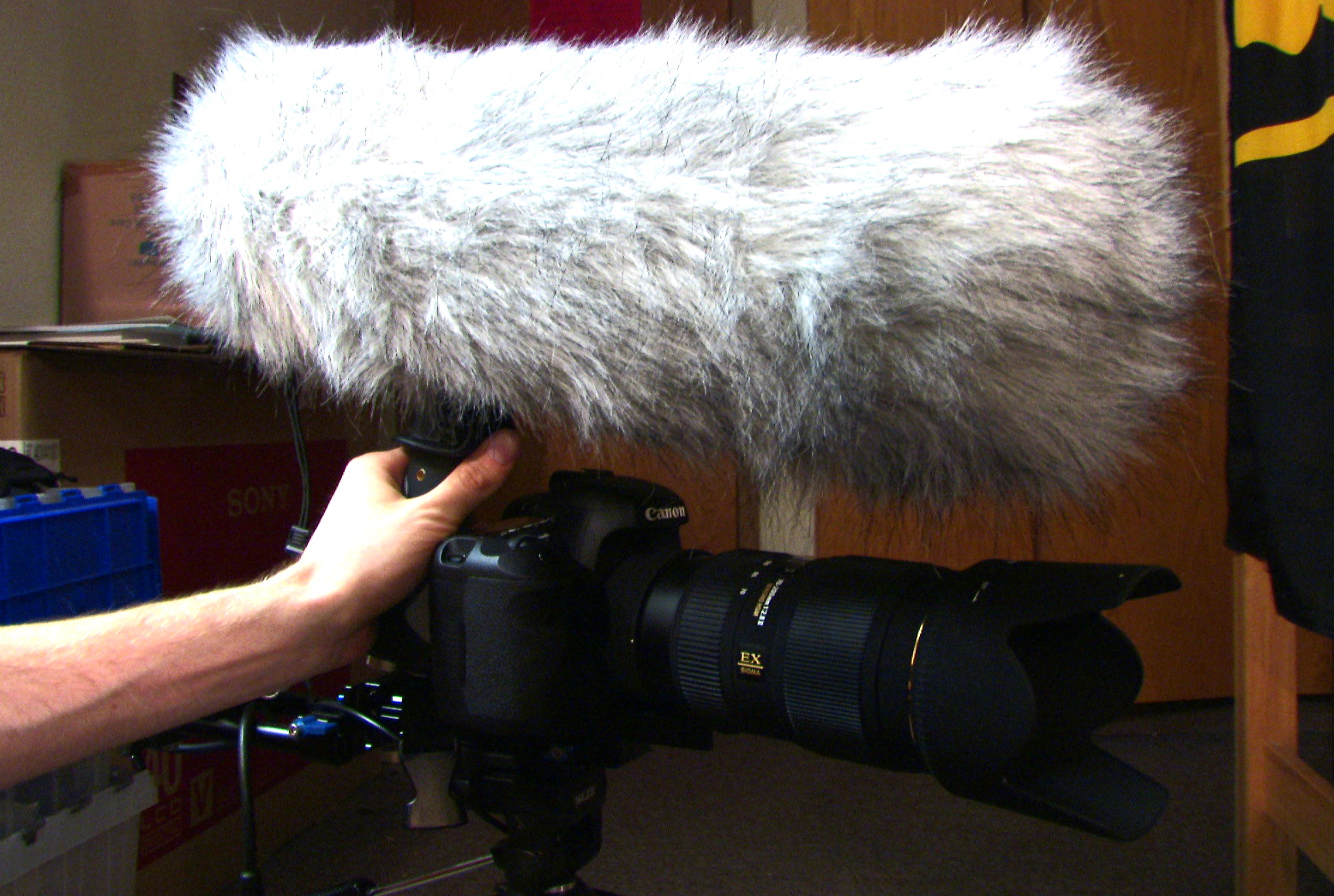

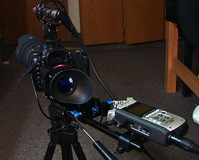

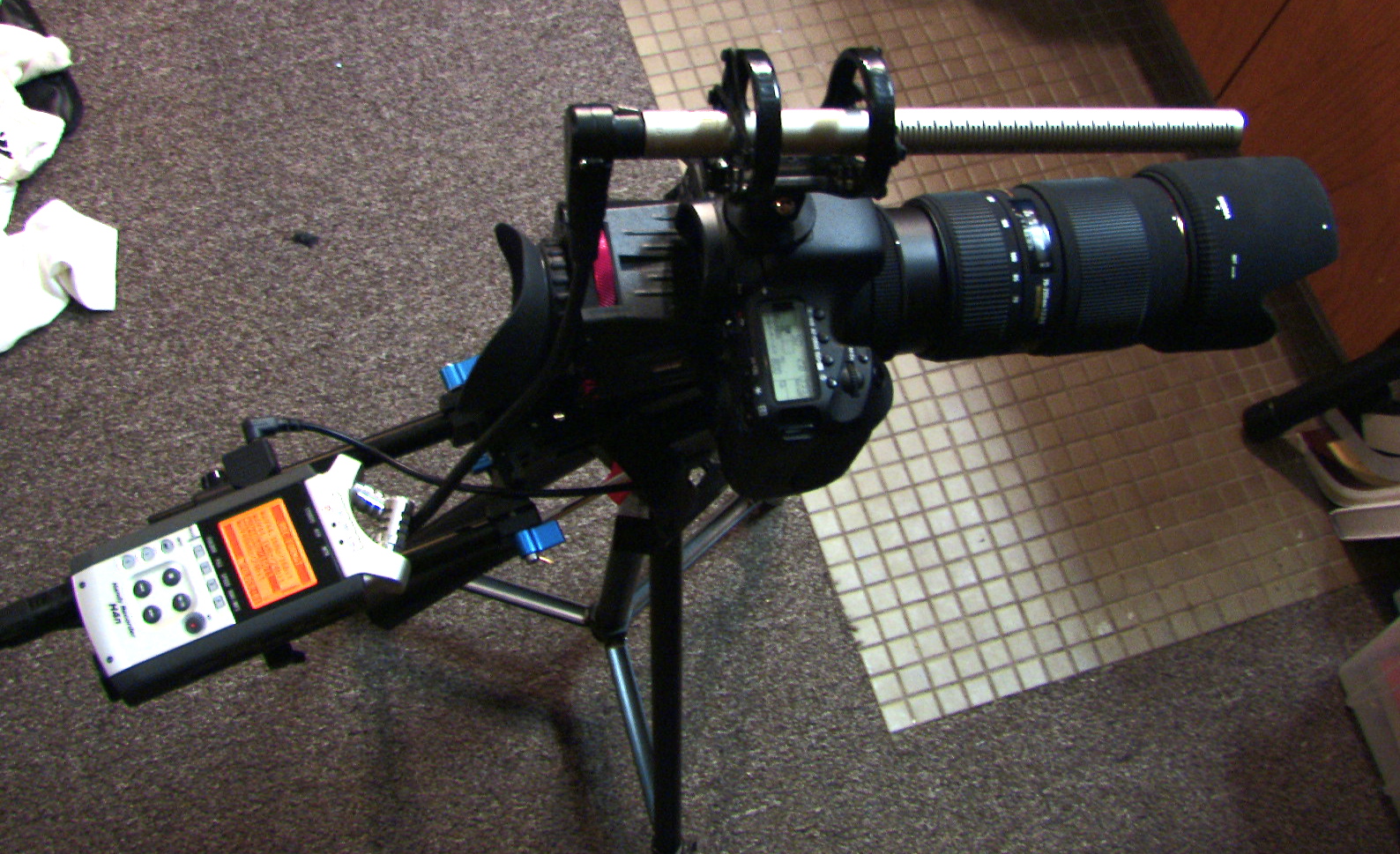

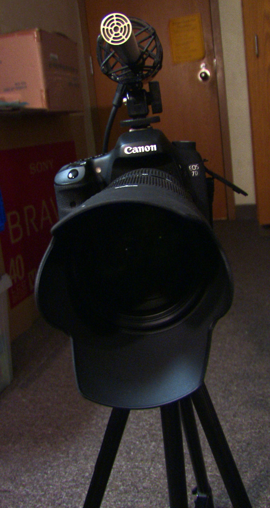

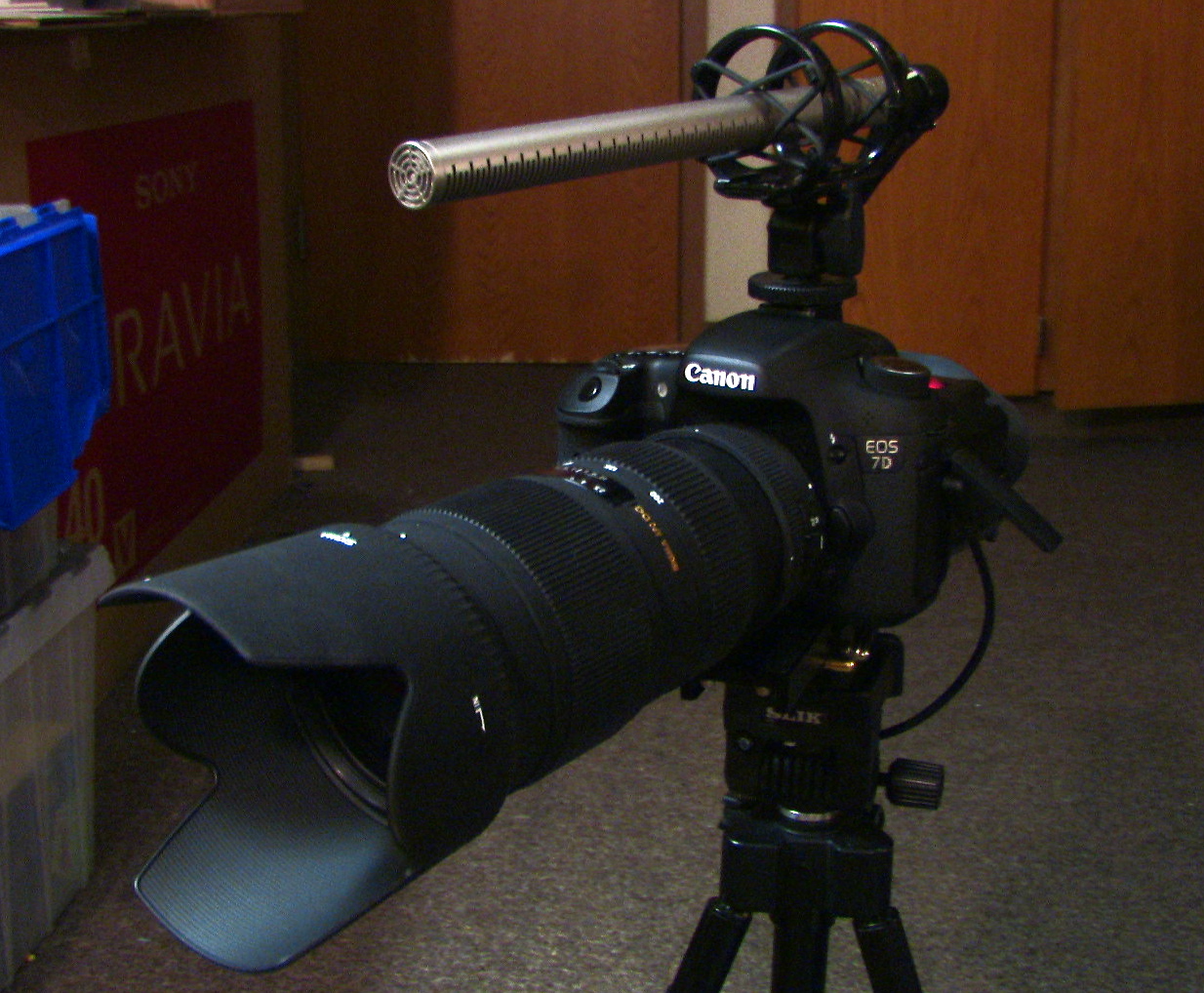

Said I'd join this board so here goes.
So, here's what I've been up to in the pictures:
-7D body w/ 70-200mm Sigma
-Zacuto Z-Finder
-Rode NTG-3 Mic hooked into Zoom H4n via XLR
-Headphone splitter to feed audio from Zoom to headphones and into the camera for reference audio (still need to figure out how to get this working ALL the time)
-And my favorite, Genus GMB/A rod system w/ cinevate universal rod mount for the Zoom (+$2.60 in Ace Hardware trinkets)
I actually put the rod system on backwards, so instead of supporting the lens, it acts as a mount for the Zoom and other equipment. I've also found that if I mount the camera slightly off-axis to the Genus plate, I'm able to use the rods as a shoulder mount while still being able to see through the Z-Finder. I have 4 points of contact that way: hand on lens, hand on body, Z-Finder on eye and rods on shoulder (just like Zacuto says we should do it!). It works rather well in my opinion, as it gets rid of the jitters apparent in non-IS lenses. And, if I stop my heart for a few seconds I can actually get some steady shots with the 200mm zoom :)
Tripod is a bit weak for this setup: it's a stand-in as my proper one is in the car. I've yet to try the mounted blimp...

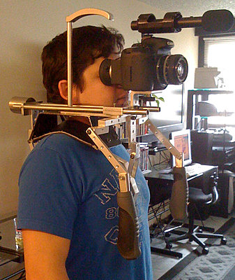

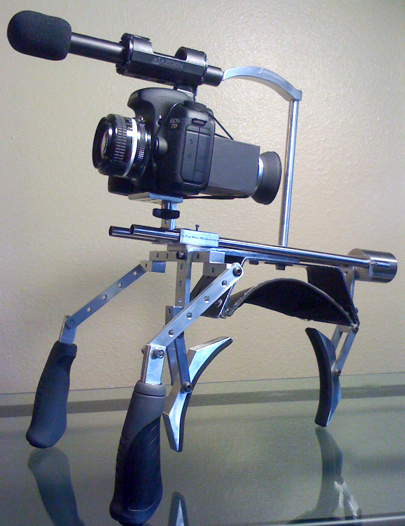

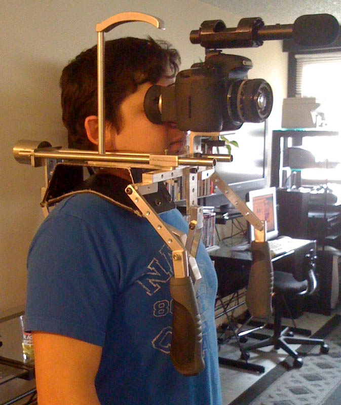

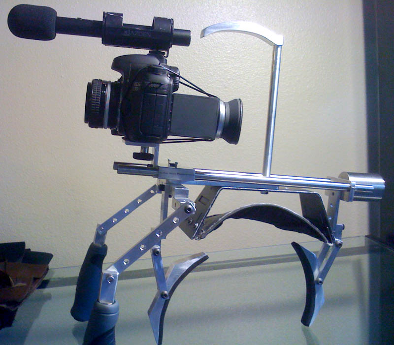

Here's mine. It's DIY and a lot of tweaking and refining to get it to this point. Made mostly out of aluminum with some stainless steel bits.
The Viewfinder is DIY as well. It's part aluminum and acrylic.
The whole thing sits on my shoulder hands free.

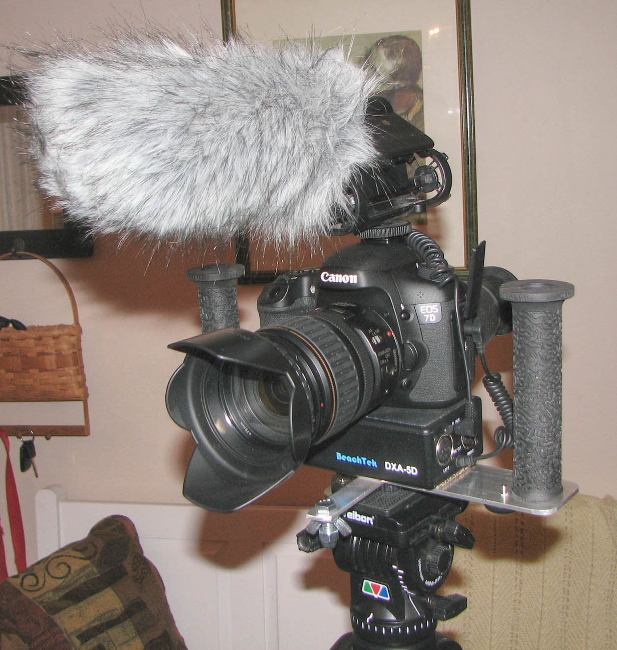

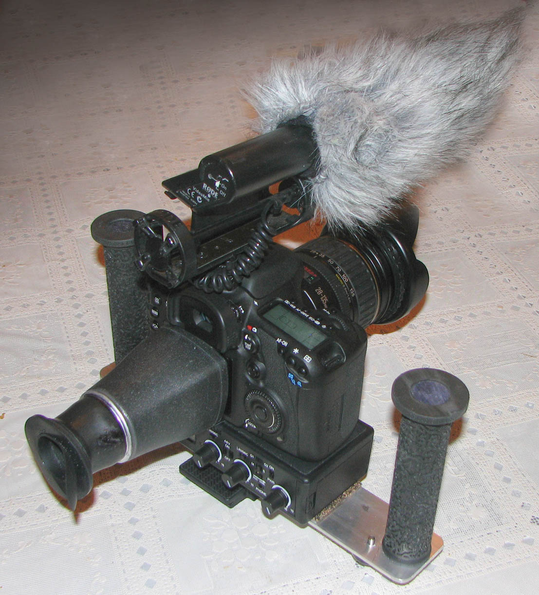

Here's one I posted a while back, though there have been a few changes with the advent of Magic Lantern.
Chris J. Barcellos

Thanks Corey. It's like a big aluminum leggo set. There are plenty more ways to configure it. Maybe I'll mess around with it later today.

Looks comfortable but don't those front and back brackets limit range of motion a lot? How's packing it up for transport?
