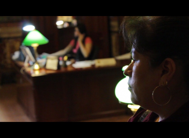

I set the camera to manual, then an ISO of 400 (200 was way too dark).
Very happy with the results, even with the kit lens. The lens was perfect in well lit areas and here is a frame grab of what I got in a pretty low light section of the building. The new lens is really going to help for sure and I am pretty happy with the results after getting the tips, thanks again.
