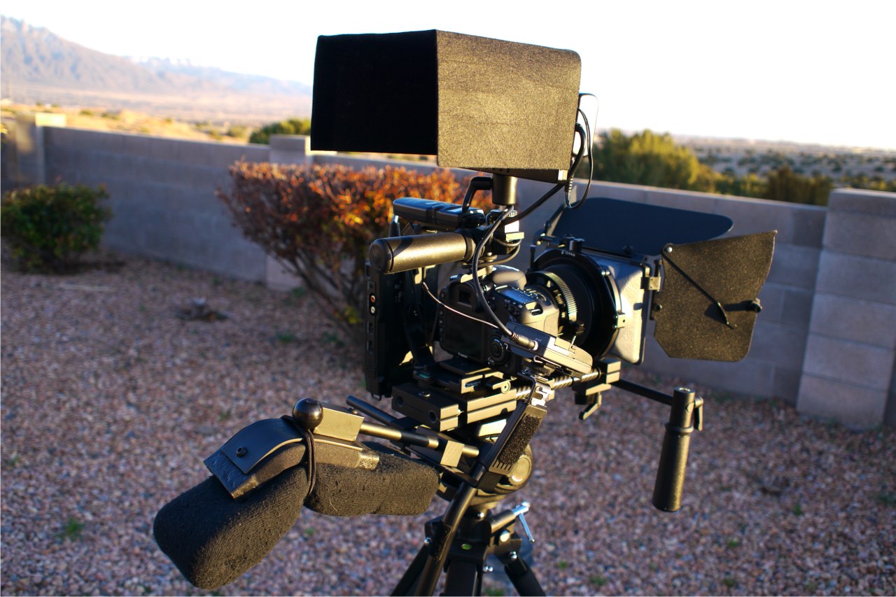

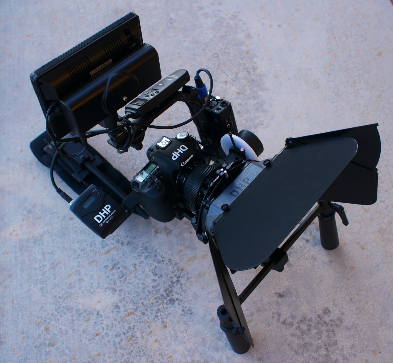

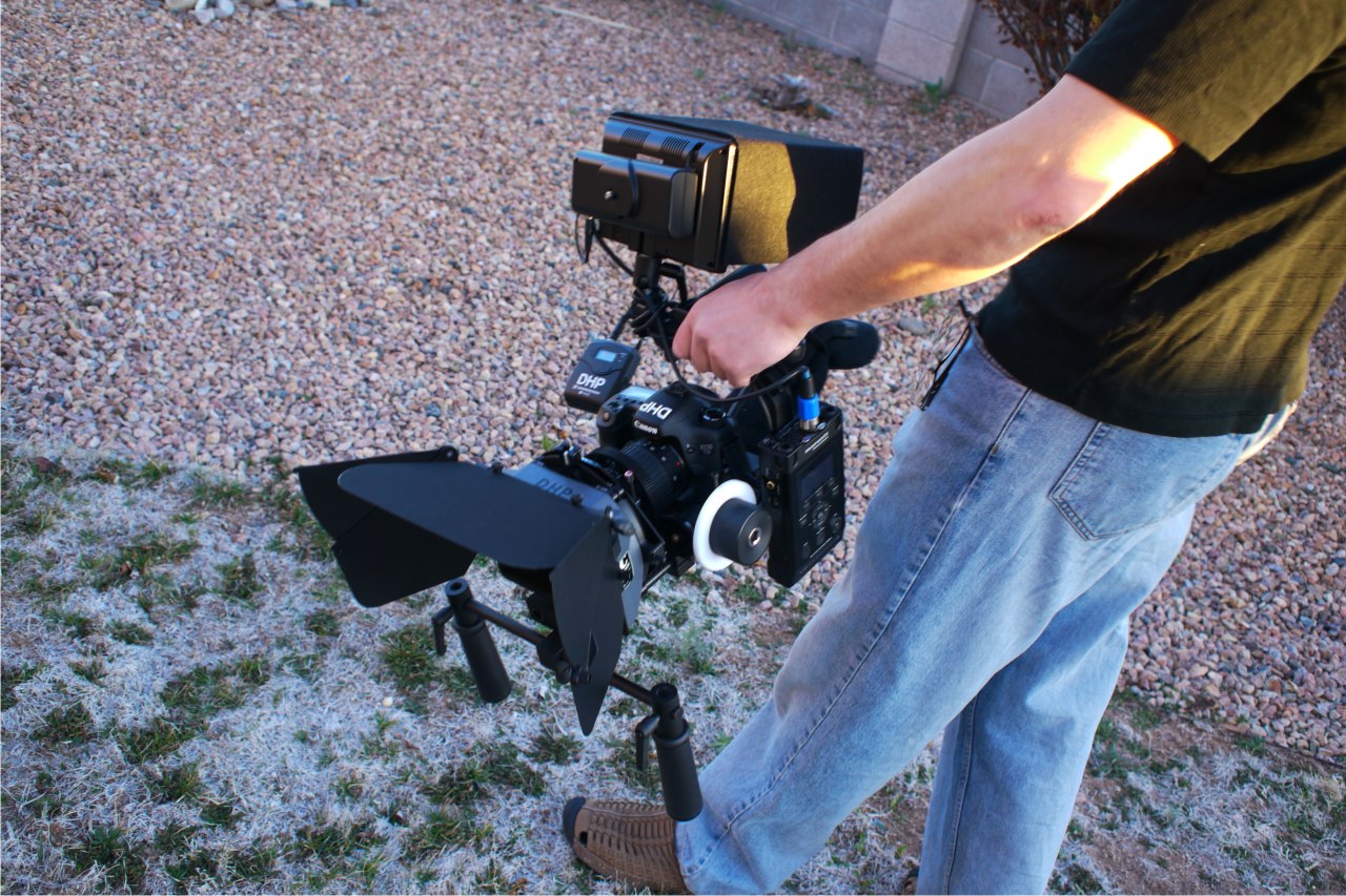

7D on STEROIDS!

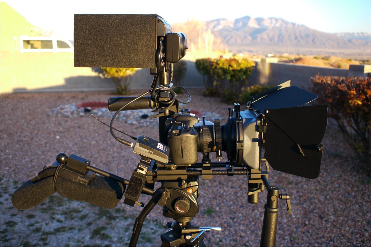

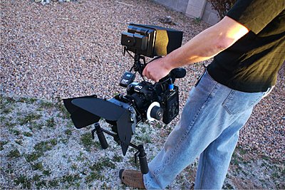

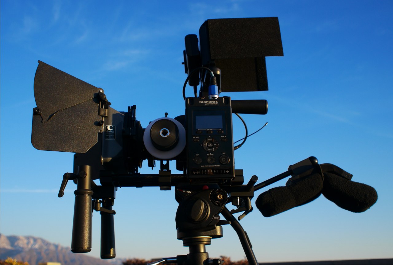

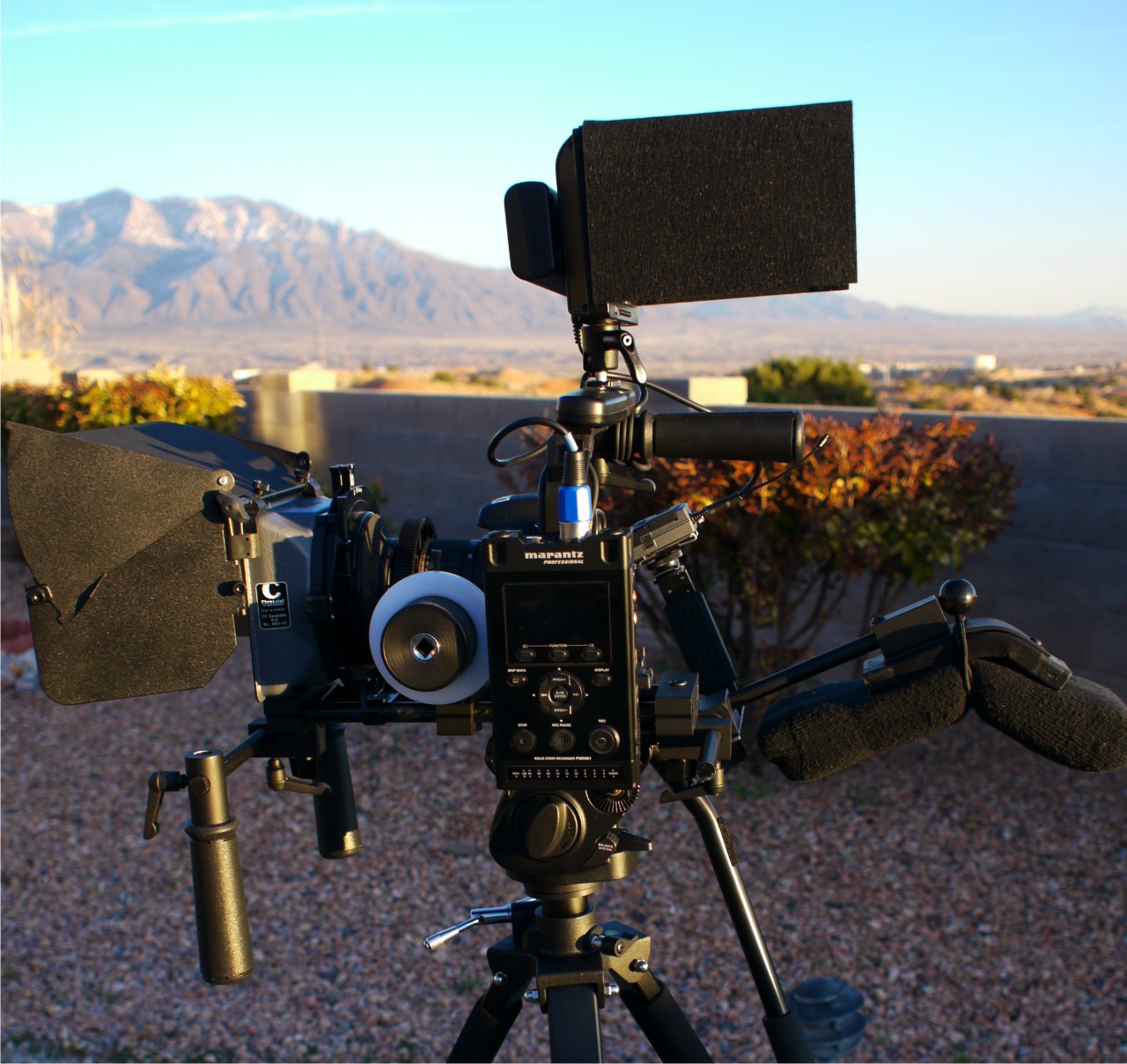

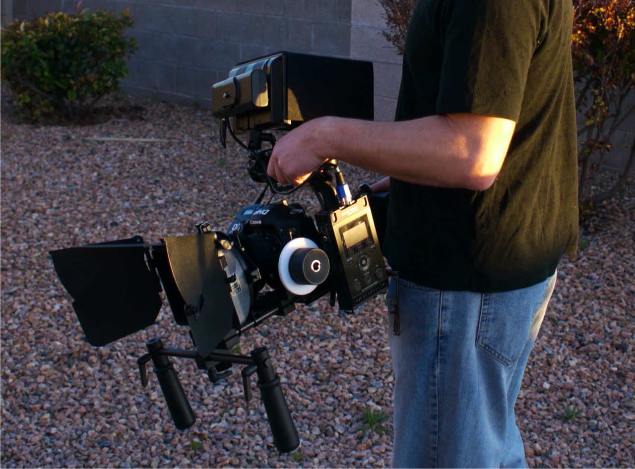

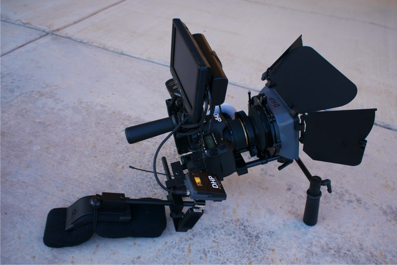

This is the rig we use when filming the The Santa Fe TV Show (when we don't use our EX1s).
Despite all the stuff hooked up to it, it's still farely light and comfortable.
It also goes from shoulder mount to regular tripod setup in less than a minute.
Enjoy!

Thank you Chris. I will do my best to price this out.
The carbon rails, top grip, base plate, "C" bar, and shoulder mount are from indifocus.com. We test a lot of stuff for them so I don't know exactly the price, but I think it's in the $350-$400 range (call Tim for accurate pricing).
The audio system in this setup is a G2 from Sennheiser, clamped on to a L shaped mount with 2 cold shoes on it (I adapted it myself and attached to one of the rod mounts of the shoulder rig). The recorder is a Marantz 661 24bit 96khz recorder. My background is audio, and I would suggest this recorder to anyone that wants great audio, whether is coming from a wireless system or a boom mike.
The monitor ia a cheap Lilliput 669. Nothing great, but enough for focusing and "seeing what your are doing". It's powered by the battery they sell at coollcd.com. I found the monitor on EBAY for $199 and the battery pack is about $60. Monitor hood is hand made ($5!...)
The matte box with french flag is a Chrosziel we bought a while ago for our EX-1s (about $1400). We adapted the side flaps from India (I don't think you need to spend top $ on side flaps...).
7D has a FF system from indifocus.com. Again, it's a new model they offer and I don't know the exact price. It's very smooth, very adjustable.
The 7D has a (non stabilized) Tamron 17-50 (about $400).
On top of the "C" bar I also have attached a Canon remote for timelapse (tc8-n3) - it does NOT activate video recording, it's just for timelapse photography (about $130 at BH)
The system is VERY versatile. It can also be attached to a tripod head with the quickrelease plate at the bottom. The front grips and the rear shoulder pad section can be detached in seconds. It's easy to carry the rig around as shown in the pictures I posted. It is also confortable on your shoulder and not too heavy.
Hope this helps.
Carlo Zanella
www.santafetvshow.com
