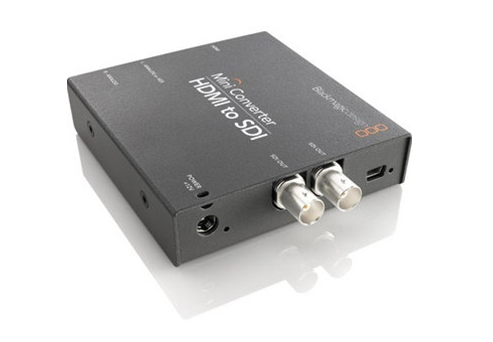

Charles has recently posted on how these boxes are powered- some inline adapter you can get from RadioShack. He could explain more. This doesn't look like the AJA box but rather the Blackmagic HDMI > HD-SDI converter. One feed is going to the Panasonic HD-SDI monitor, the other feed to video village / wireless focus puller.
7D really is the only option right now, since it is always 1080i, even when the record button is hit. You couldn't use this setup with the 550D or the 5DII, as it would switch to 480i video out. Not sure about the 1DIV

What I'm seeing on this rig is (on the rear, from top down):
Camcorder battery and cradle
Blackmagic HDMI to HD-SDI converter
Preston MDR (for remote focus)
Main Battery (Swit, I think).
Main battery would be powering the Preston, the Panasonic monitor and the BM box (via stepdown conversion); no clue what the camcorder battery is powering.
As noted above, you can see the focus puller at the monitor (with blackout hood) with the Preston hand unit hung around his neck.
Ryan, to answer your question about the AJA convertor--it's just voltage, babe. Simple voltage regulation circuit and you are off and running. We had the AJA on "Nocturne" but weren't aware that the box ran on 5v (I've used AJA downconverters before, they can be powered direct from the 14.4v battery via p-tap) and we fried the sucker immediately. Vincent and I have since switched to the Blackmagic as it handles the slightly oddball signal out of these cameras better. Still requires regulation down to 12v nominal but that's not a big deal.
Perhaps they are using the camcorder battery to run the Blackmagic--not sure if it will run on 7.2v nominal though.

This is from Jimmy Lindsey - the DoP on the shoot giving some info on the rigs (posted on Phil's site):
"Jimmy Lindsey here. The man in the brown hat with the Z finder. I was Robert’s DoP on the ‘Bob Schneider’ music video (as well as his last feature ‘Machete’) and those are my 7D rigs at work. After seeing all the questions, I thought I might shed a little light on the subject. The rig Robert is using was set up to allow him to see an HDSDI image on a 7″ Panasonic onboard monitor while his AC (the insanely talented Sebastian Vega) pulls focus with a Preston FIZ from a 17″ Panasonic monitor. Very necessary as you know when shooting on a 200mm at a 2.8. The signal was split from HDMI to 2 HDSDIs using the Aja Black Magic powered by a Nebtek adapter and Sony M batteries. Both the Preston and the onboard were powered with a D tap cable and a Sony onboard battery. We also got some beautiful shots with my 50mm 1.4 and a lensbaby composer with single glass and plastic optics."

Originally Posted by Danny Dale View Post
Jimmy Lindsey (posted on Phil's site):
"...The signal was split from HDMI to 2 HDSDIs using the Aja Black Magic powered by a Nebtek adapter and Sony M batteries."
Think Jimmy has his manufacturers mixed up, read this on Phil's site too.
No such thing as an Aja Black Magic. ;)
They just used the mini converter from Black Magic, which provides two HD-SDI taps out.
(photo attached). Retails for $500.
