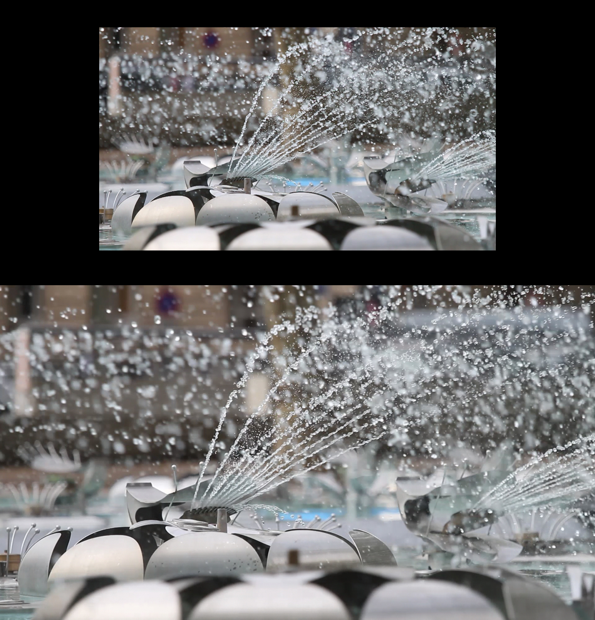

Reference beta footage from Anton Nelson on Vimeo:
Canon 720P 50FPS BETA FOOTAGE on Vimeo
Canon 7D 1080P 24FPS (beta footage) on Vimeo
Original 1080 & 720 files available to download for registered Vimeo users.
On download of the 720 50fps video, look at the jaggies around the edges of the metal sculpture, compared with the 1080 version.
The 1080 version looks very similar to the aliasing artifacts on the 5DMK2 around the edge highlights.
Of course this is a beta model.
Full res grab attached:

Originally Posted by Xavier Plagaro View Post
Wow, I don't see the technical problems, I see wonderful images with very little artifacts. Moving water is pretty hard for AVCHD...
Xavier it's not the codec or general compression but the in camera scaling.
see pic below.

Hi James. I can see the antialiasing scaling artifacts, but to me they are not as nasty as the blocking artifacts at the bottom right of the picture, in the out of focus area. It's not obvious in the stillshot, you need to look at the moving video. If this footage is really direct from the camera it doesn't look very good at all for anyone who is looking for shallow depth of field with attractive bokeh.

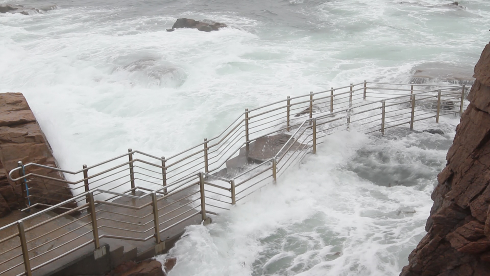

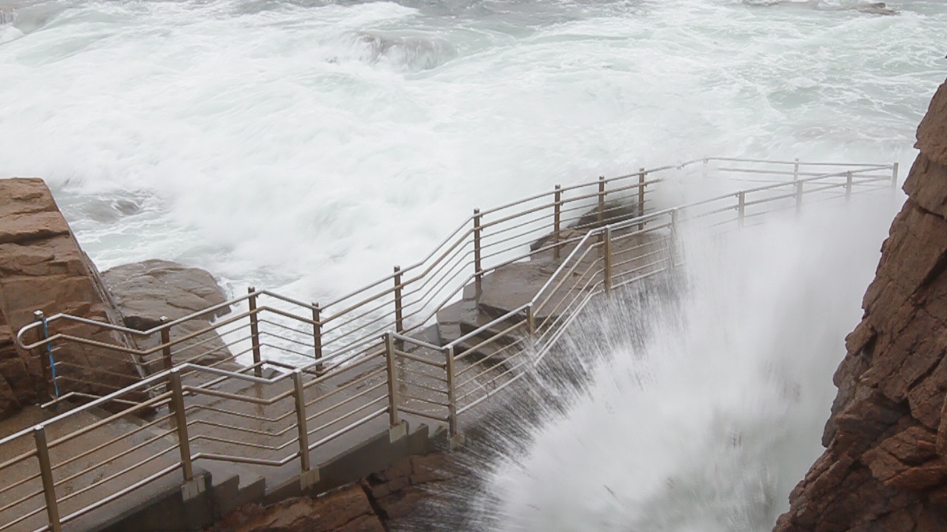

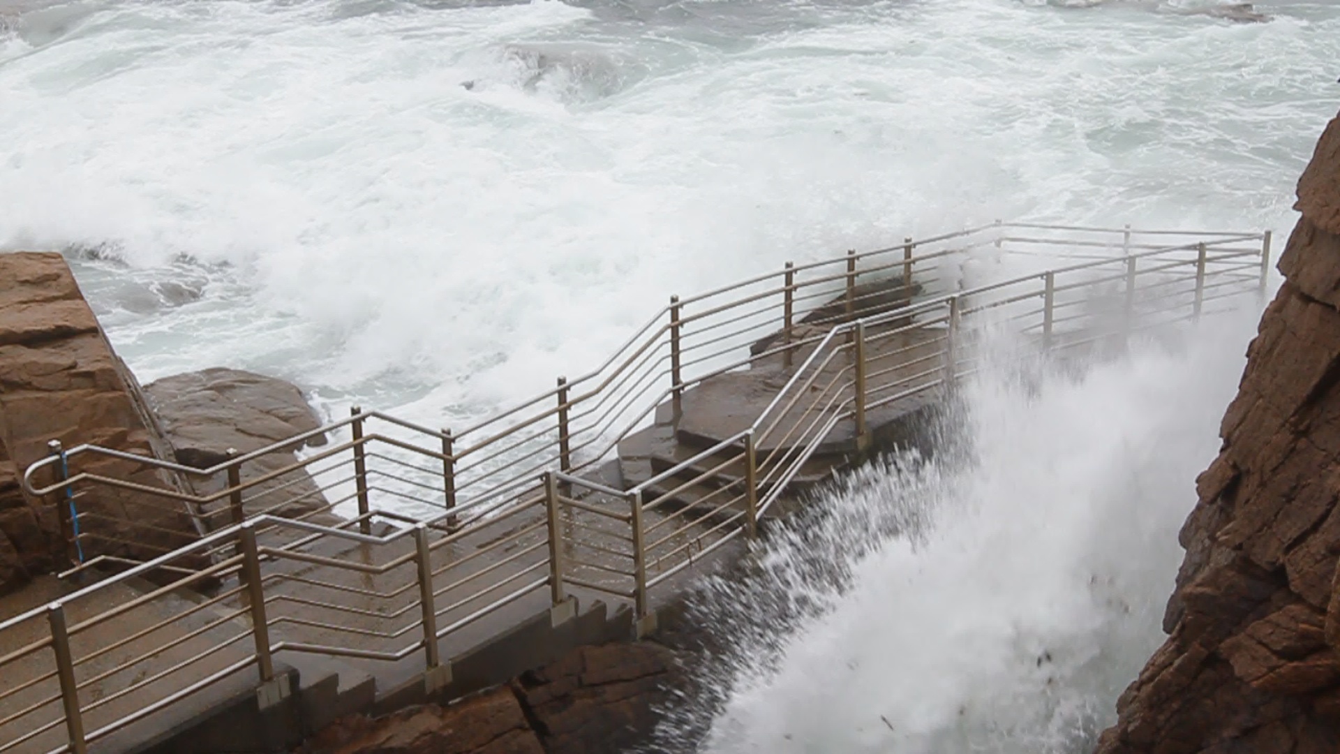

I took the Galbraith footage, and converted it using Cineform's Neo Scene.
It looks like Cineform is changing the levels, as with the 5D footage, giving the footage more detail in highlights and in the shadows.
Second, there may be some improvement in both the 720 and 1080p material with respect to aliasing an moire. But I will let you judge for yourself. See the attached grabs.
Aliasing Artifacts-thunder1080orig.jpg   Aliasing Artifacts-thunder1080cineform.jpg
Aliasing Artifacts-thunder720orig.jpg   Aliasing Artifacts-thunder720cineform.jpg
Cineform is changing the levels as compared to what? From what I've seen, the older version of Quicktime clips the blacks. The newer version raises the gamma. Cineform, on my system decodes properly and sets the levels to 16-235. You can also get the correct levels by re-wrapping the MOV files in Quicktime to M4V (or is it MP4?) and applying the computer to studio filter in Vegas.
Chris,
In your 720 orig and cineform grabs, are those from exactly the same frame? The water streaks from the splash look significantly different.
If they are then the recompression is doing a lot of changes.
Ted

Ted:
I forgot and pulled that frame from the end of the clips.. Cineform actually retimes, so I think that is why I was off. I will recheck.
