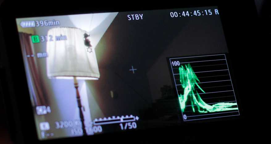

Thanks you for this change - I like mark II a lot.
I still work on my test, I have a lot of photos for some WFM part .-) (I have 17 years of broadcast working and I can recommend to use it).
See attachment.
